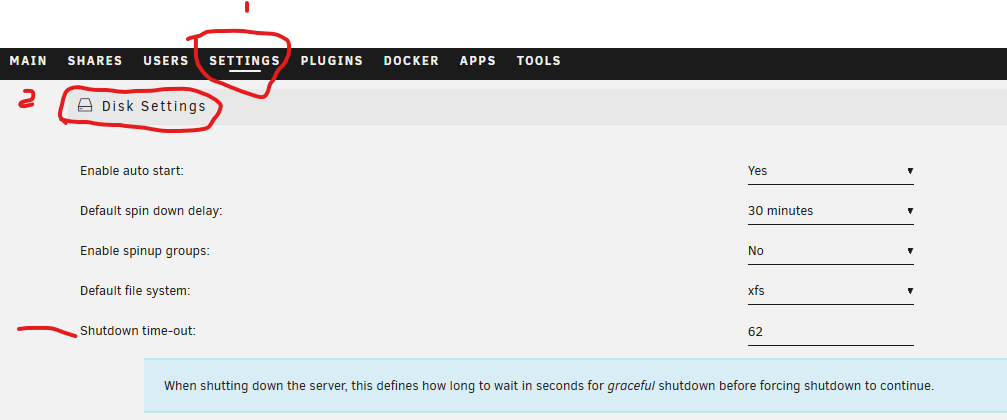

There is a setting designed to do this:
This setting is one that you can determine by timing the actual time in seconds after you manually click on the STOP button to take the array off line.  (I consider this setting to be the one that is the last thing that can prevent an unclean shutdown.  As I understand, if the array is still is not stopped when this timer expires, Unraid will then force a shutdown and it probably will be an unclean one!)

Thanks for the tip.  My shutdown time-out was set to 90.  I bumped it up to 120.  I timed stopping the array and it too 45 seconds.  (my cache stats showed 10+gb).  What's weird is that it had been over an hour since I copied a large file to the array (which gets copied first to the ssd raid 1 cache drive, the manually I press move to move it to the mechanical drives.  I assumed that when I stopped the array, it finally dumped the cache of the move to the mechanical drive.  When I restarted the array, the cache stats showed less than 4gb.  Any ideas why it holds the data hostage in cache instead of writing it to the array immediately?

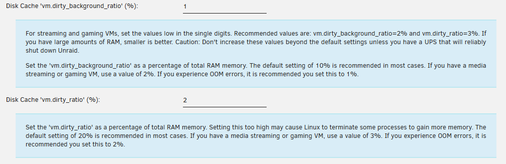

One more thing, The Tips and Tweaks plugin has two settings that control the RAM cache that Linux uses for write operations.  This is a screenshot of those settings with the 'Help' for them:
The more memory that you have the more data there will be to be flushed.  (Those defaults were set when 2MB was the typical amount of RAM in a Linux computer.  That 20% represents 400KB for 2MB of RAM.  With 32GB, that becomes 6.4GB.  Stop and think how long it takes to write that much data to an HD.)
