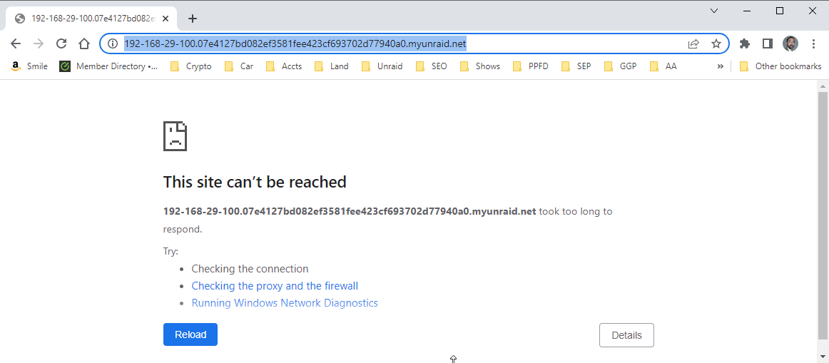

Unraid 6.1.1.  Server was at 192.168.29.100, router failed and new IP was forced to be different (long story).  New server IP is 192.168.4.100.  Server boots and Plex works fine.  Unable to access WebUI.  Edited network.cfg file from console to get server IP address fixed.  Now the new IP redirects to the old server URL (https://192-168-29-100.07e4127bd082ef3581fee423cf693702d77940a0.myunraid.net/login) and says the site can't be reached.

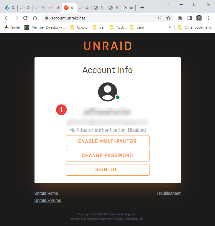

I've also tried to access my "myservers" account at https://account.unraid.net as I have before, but all I get is the attached screenshot.  User id and email is correct.
