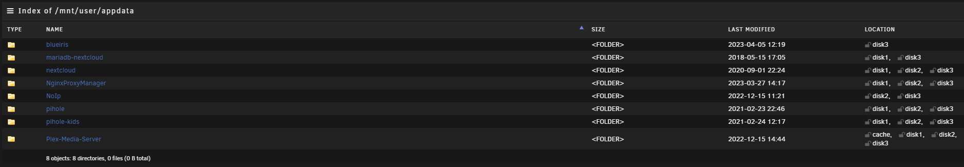

OK, I have finally added a cache disk, formatted it, stopped docker service and set the appdata share to Only:Cache - I have invoked mover, but it finishes instantly and doesnt seem to be moving.  The cache disk shows 191 reads and 56 writes... but nothing more and its not going up. When I look at the appdata location it is still showing as on the array.

Should I manually copy the folders & files from /mnt/user/appdata on the array to /mnt/user/appdata on the cache disk and then delete /mnt/user/appdata from the array disks?
To get mover to transfer the files set Use Cache=Prefer.   Mover ignores shares with the Only setting.

It is looking like mover has stalled moving some of my dockers over... there are a few odd files which wont move and I believe I can delete them but would like to check...
I have a pihole docker which says that most files are in /mnt/user/cache, but there is one file left on disk 2 - /mnt/disk2/appdata/pihole/pihole/!macvendor.db (size 13 bytes)
My Nginix Proxy Manager has a file left on disk 3 - /mnt/disk3/appdata/NginixProxyManager/!logs (size 3 bytes)
In Midnight Commander the above filenames are coloured red and I am thinking mover cant move them and they may be orphaned files - can I just delete them, or should I copy them to /mnt/user/appdata?
I do also have a blueiris docker, which seems to be unable to move thousands of files which are in the /mnt/disk3/appdata/blueiris/drive_c/ & /mnt/disk3/appdata/blueiris/dosdevices/ folders... this might be because the files in Nginix Proxy Manager and Pihole are stopping docker before it has completely moved BlueIris... but either way once the Nginix Proxy Manager and Pihole issue is solved - is there anything to stop me moving BlueIris' files in MC to the new SSD /appdata/ folder?
Thanks
Did you disable the docker service before running mover?   This will be needed or some files will not be moved.
Yes, it is disabled @itimpi
OK... I thought as all mover does is moves the files, it wouldnt hurt to move them using MC... so I moved the ones which seemed stuck onto the cache disk and now it shows as all my dockers & VMs on the SSD cache ;-) And its all working perfectly again
