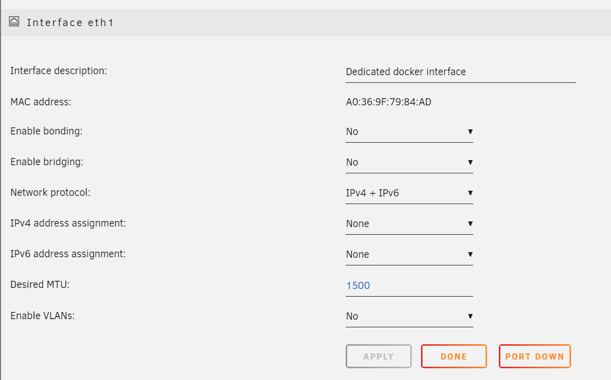

1. Stop the array and navigate to Settings -> Network Settings and configure the dedicated interface
    - This guide assumes eth1 will be the dedicated interface, adjust for the appropriate ethX device as needed
    - Disable bonding and bridging for this interface (important!)
    - Use IPv4 only or IPv4 and IPv6 as per your case
    - No IP addresses are assigned to this interface

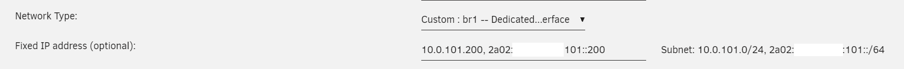

   - Assign manually the "old" assignments to the new dedicated interface (use eth1, not br1 as shown in the image)
3. Start the array and configure the Docker containers with the new custom network
    - Any containers that previously had "Custom: br0" should be changed to "Custom: eth1" (not br1 as shown in the image)
    - IP addresses may be fixed (as in the example below) or dynamic using DHCP (configured in the previous step)

Make sure to have “IPv4 address assignment:” set to “none” for your eth1. (As well as for ipv6).
