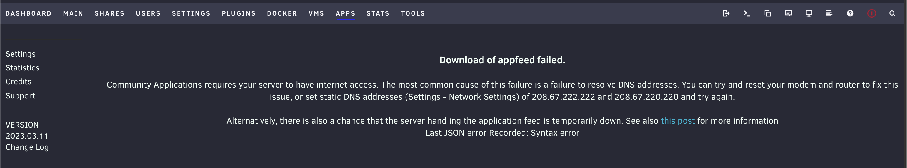

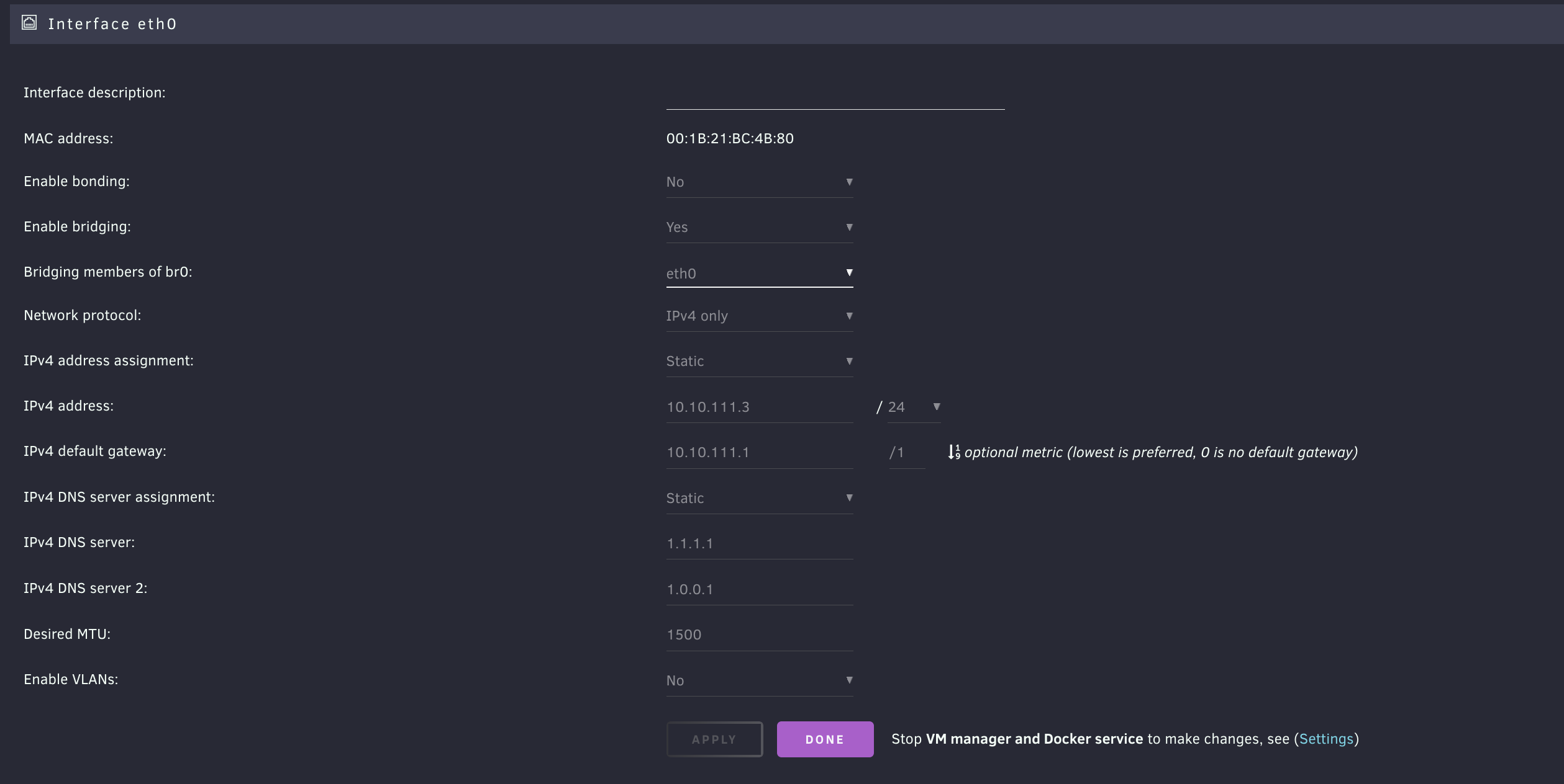

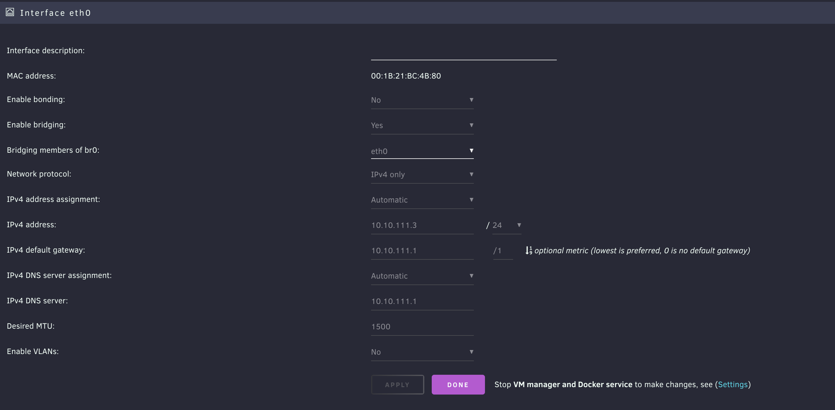

I attached a screenshot of the settings I used when attempting to set a static IP. Unraid doesn't like my DNS settings but only with the static IP. pfSense gives the same DNS settings. I loose br0 after every reboot as well.
Your screenshot shows different settings.
pfSense uses cloudflare DNS servers. So Unraid wants the gateway IP for both primary and secondary DNS servers?
