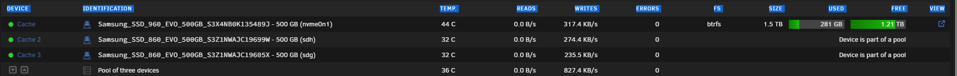

I have a new 500gb NVME going to replace my old one with.  I have cache pool so not 100% sure how to do this.

I believe it was converted.  So can I now swap it out?
milyard-tower-diagnostics-20230403-0922.zip
