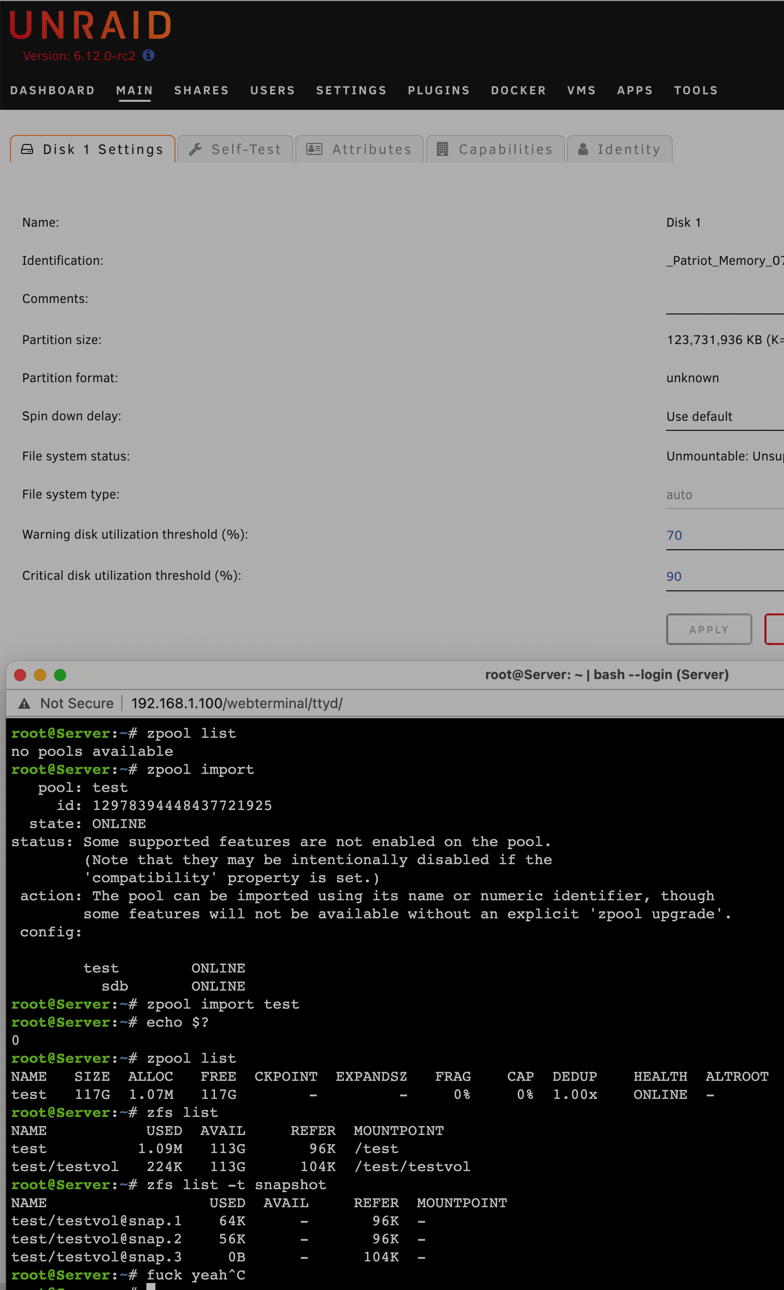

  1. Importing zpools from FreeBSD. Works fine on the CLI. Pools import, zvols mount and are writable. Snapshots can be rolled back and data integrity is good (checked with md5sum). The Unraid UI doesnt recognise them and won't mount them. Wants to format them. I was hoping this could've been an in-place upgrade, like magic trick, without a 30TB data migration. The zfs master plugin sees the pools and vols.

  3. Zpools /zvols created on the CLI in Unraid aren't useable by the UI. Sreenshot attached.
Were these pools created with FreeNAS/TrueNAS? If yes they cannot be imported so far because zfs is on partition #2, this should be supported in the near future.
ZVOL functionally using the GUID is not yet implemented yet, you can use them but only using the CLI.

Re #1. They were created in native FreeBSD. And they imported into Unraid just fine, but *only* on the CLI. The UI didn't see them. The screenshot I shared has the UI reading --> disk 1 "Unmountable: unsupported", and right below in the CLI, I imported and listed the zpool, listed the zvols and snaps, followed by a happy comment. I can confirm the actual import works and IO works.
