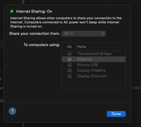

I just started using Unraid and I'm using the trail version. My server is directly connected through an ethernet cable with a Mac.  Also an internet connection is being shared from my Mac through the same ethernet connection.

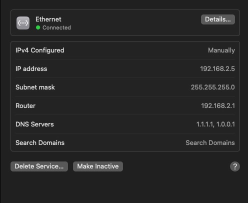

Th shared ethernet settings on my mac:
IPv4 Manually configured
IP addres: 192.168.2.5
Subnet mask: 255.255.255.0
Router: 192.168.2.1
DNS Servers: 1.1.1.1, 1.0.0.1

Have you tried setting the gateway instead of being the router to be the IP of the Mac?  Shared internet is (nowadays) a real oddity in setting up any home network.
Also, any change if you use DHCP on the server?
Thx for the reply @Squid. I gave up the idea of sharing the internet from the mac.
In the end I purchased a cheap wireless router and set up as a repeater. And it's working now.
