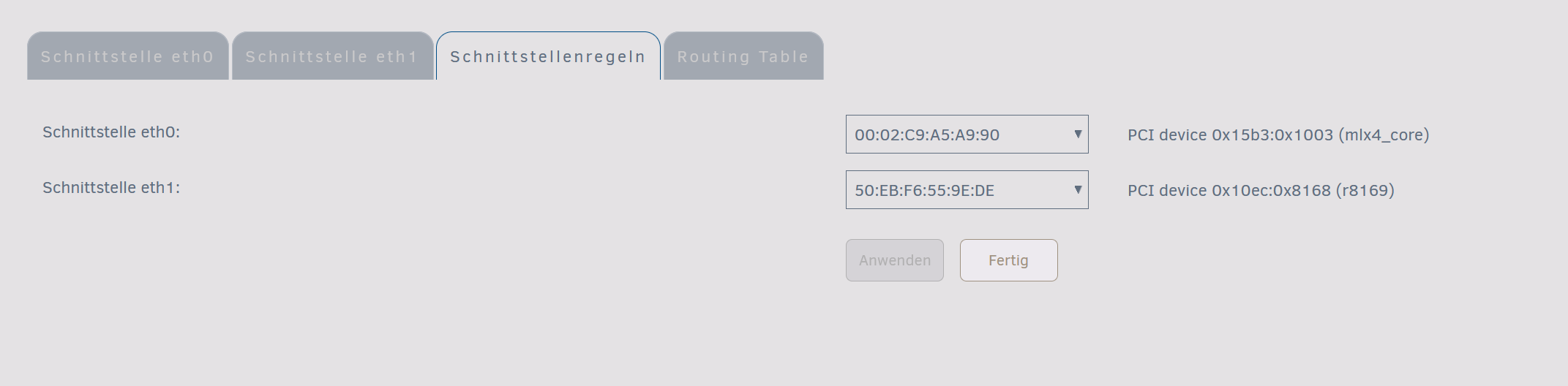

Then: look below (or, depending on your settings, on a different tab)
Here you will see the MAC addresses of all NICs (should be 4 in your case).
Move the one with your cable to "eth0" (and maybe resort the others too). reboot.
Your current "LAN 3" will become "LAN 1" with this.
You now will have the main lan on your desired card, without any bonding.
