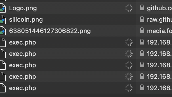

Hey there, still experiencing this behavior. Is there any info I can provide to help replicate or troubleshoot? Seems to be hanging on the exec.php but that's all I know thus far
Edited by cambriancatalyst
Added info
Best guess would be is this a rather crippled Mac?  (ie: very slow /  very little memory)?
FWIW, via VMs / Tablets / Phones I have never been able to replicate any safari issue, and by and large the vast majority of Safari users have absolutely no problems, and since FF / Chrome will fix the problems its definitely something with the setup of the browser.

Anyways, this should be fixed on the next rev of CA (Monday ish release)
