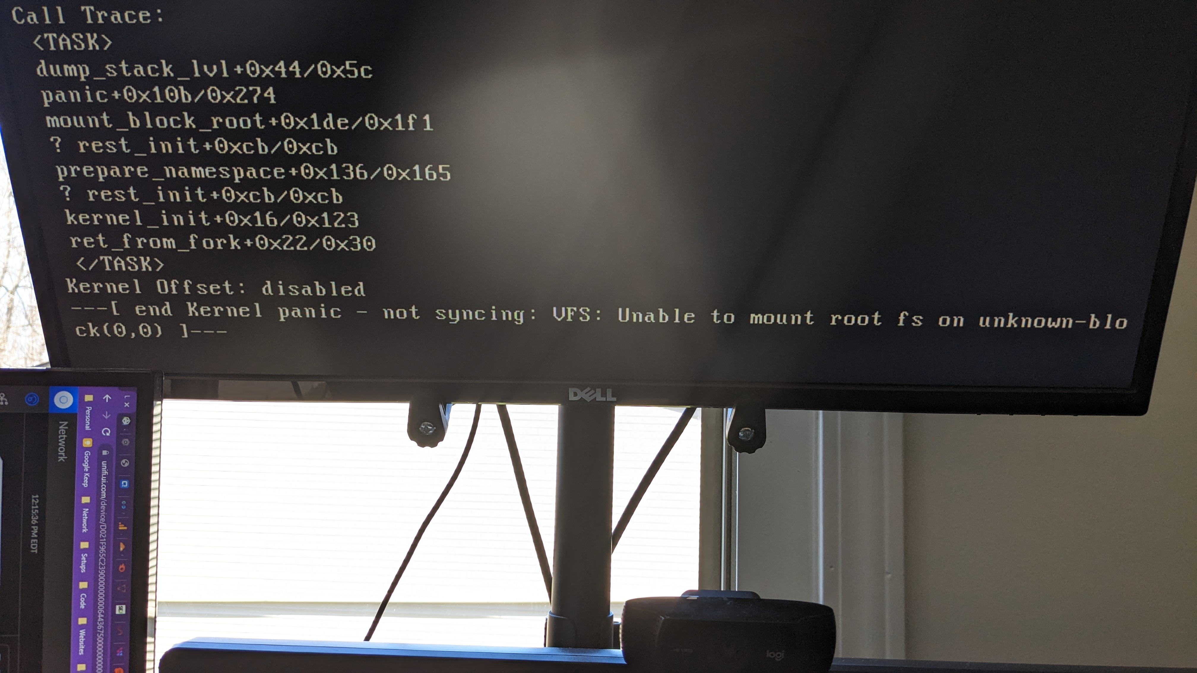

Error: [ end Kernal panic - not syncing: VFS: Unable to mount root fs on unknown-block(0,0) ]
Screenshot attached of error. Error: [ end Kernal panic - not syncing: VFS: Unable to mount root fs on unknown-block(0,0) ] What I've done to correct said error: - Backed up my server config - Bought a new USB and created a new boot device using the Unraid USB creator with my .zip backup file.
How much memory do you have?
64gb of Ram

64gb of Ram
try creating again? maybe use manual method.
Just tried this and nothing has changed, same error.
Okay so I think I fixed it by updating all the bz files now my question is how do I move my key over from my old system?
