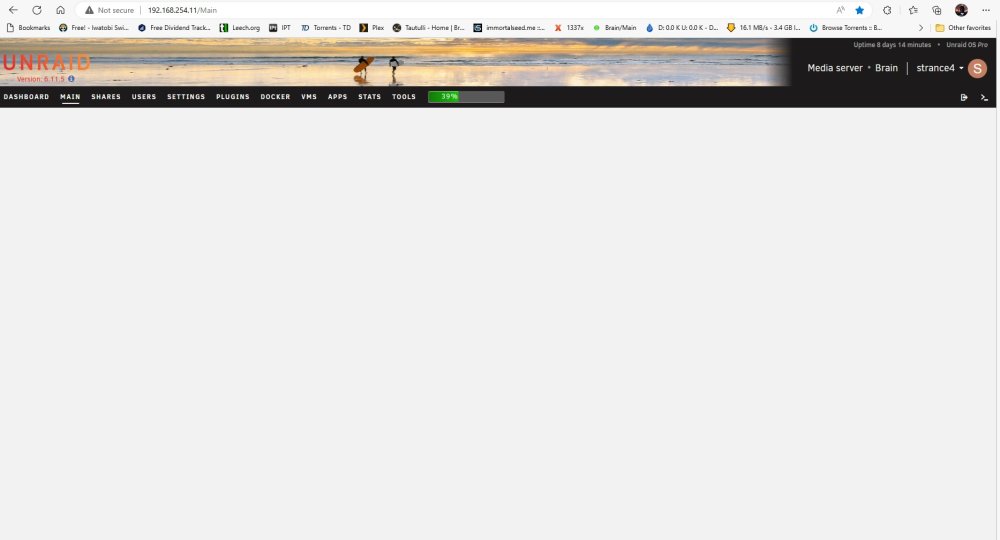

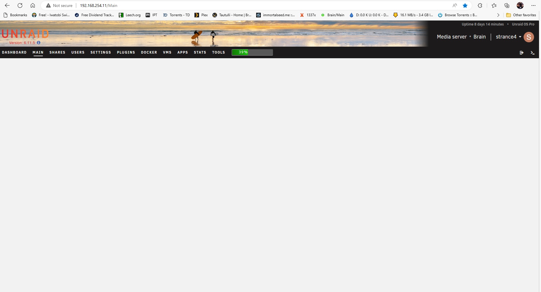

Web UI Not showing anything.
Hi guy Request some help.
I went to work and came home and i cant see anything no matter what i do. Everything works Dockers and SMB folders. I have listed below what i have done request assistance i dont want to restart through terminal and then it wont work.
I swapped from chrome to edge to firefox no change.
I try clicking on DASHBORD MIAN SHARE USERS and there is no change on display.
I tried login with other User no change.
I reset the WEB Ui using the code from space invader video.
Any assistance much appreciated.
