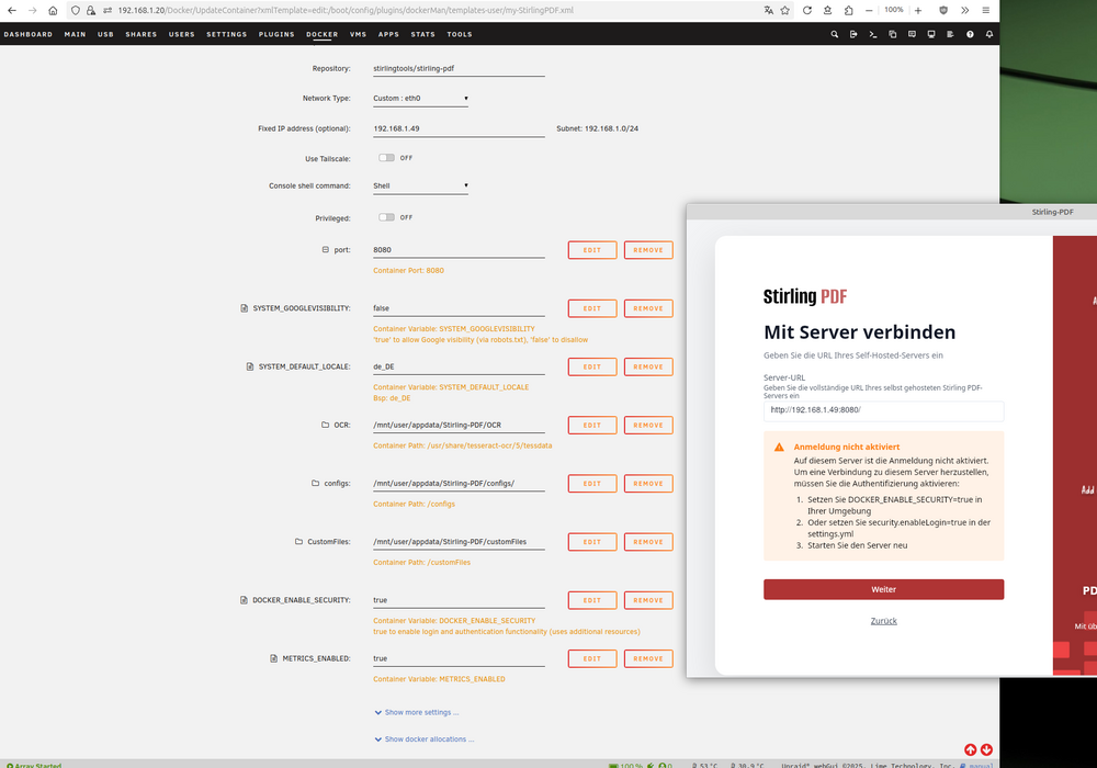

Hello,
I ask for help with StirlingPDF (Froodle).
this docker container is installed since a long time allready on my unraid-server. working fine, without any troubles.
the container has got its own IP http://192.168.1.49:8080 and is reachable by browser.
today I have seen that the Stirling project offers a client for linux Stirling-PDF-linux-x86_64.deb and I installed it on my linux mint system.
the client starts and asks for connection to public or local server. I choose the local one, but can't connect.
there is a error warning showing up saying "login not activated".
(translated from german)
On this server, the login is not activated. To connect to this server, you must enable authentication:
1. Put DOCKER_ENABLE_SECURITY=true in your environment
2. Or set security.enableLogin=true in settings.yml
Restart the server
but the docker .yml is set to  security.enableLogin=true
I did try as well to set the server adress in the /.config/Stirling-PDF/workspace/configs/custom_setting.yml of the client on linux mint, but this doesn't make any difference.
server:
host: 192.168.1.49
port: 8080
server and client restarted, but no success. seems like there is something blocked. don't know if I am doing something wrong or missing anything.
unraid is @92.168.1.20 and mint system @192.168.1.11

any hints are welcome and thanks in advance.
edit:
I deleted the docker and settings and created all new.
now it's working.
Edited by NoRaid99
