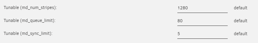

Yes, something to look at, but for normal usage, i.e., with parity you are not able to hit those bottlenecks, so not something that most users will ever run into, changing these settings might also make a difference (Settings -> Disk Settings):
Thanks for the report, I'll do some tests myself when I have some time.
