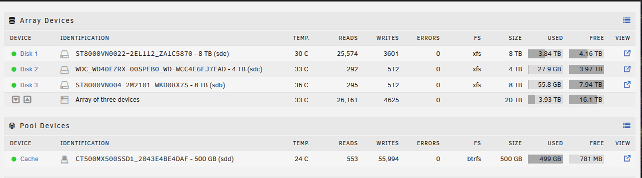

Here space occupation of the array :

Click on the share or shares you are using and set "minimum free space" as mentioned.
i have just change it since first answer :
You will have to run mover manually to get files moved from cache, or wait for it to run at the scheduled time.
Best if you don't attempt to cache initial data load, or any file transfer larger than cache.
It is impossible to move from faster cache to slower array as fast as you can write to cache, and trying to move while still writing to cache only makes it worse. Mover is intended for idle time.

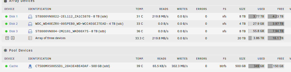

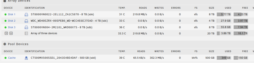

some thing strange ....
i have put 40G for min free space (appdata and media shares).
I have deleted files directly in the cache disk to free space ....
all my dockers are stopped .... now i see my cache to be filled from disk1 to cache...
You're right regarding the speed "issue" between SSD cache and HDD....
i have missed something hughe ?!
