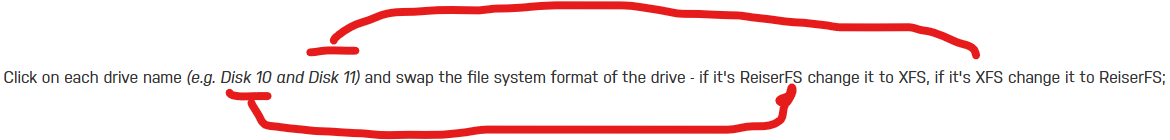

I have make a screen capture of the part that is confusing IF you don't read it very carefully!
Notice that I connected the action required for each disk if the condition specified is found.  At the point Disk 10 should be formatted as XFS and Disk 11 should still be formatted as ReiserFS.  As I recall, at the time when these instructions were written there were earlier versions of Unraid where the disk format on the actual drive was not properly detected.  (There still may be folks running those versions, so the instruction has never been changed. ) Do the check and if it is correct, go on to the next step.
