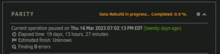

Issues encountered
All the drives in the current array are spun up, and the transfer speeds are initially low (5-20MB/s per disk).  Then later they spin up to 205MB/s per disk. Then I get variations of disk speeds down to 5-20MB/s range, and sometimes the CPU get pegged at 100% for a few min, then returns to normal usage >10%, and the disk speeds increase again.  After some amount of time I come back to check on the progress, and the array has stopped, multiple drives are showing errors on the Main screen, multiple drives are showing elevated 199 UDMA CRC error counts, uptime is less than the time from when I started the swap drive process, and of course many texts from my friends and family that they cannot access plex.

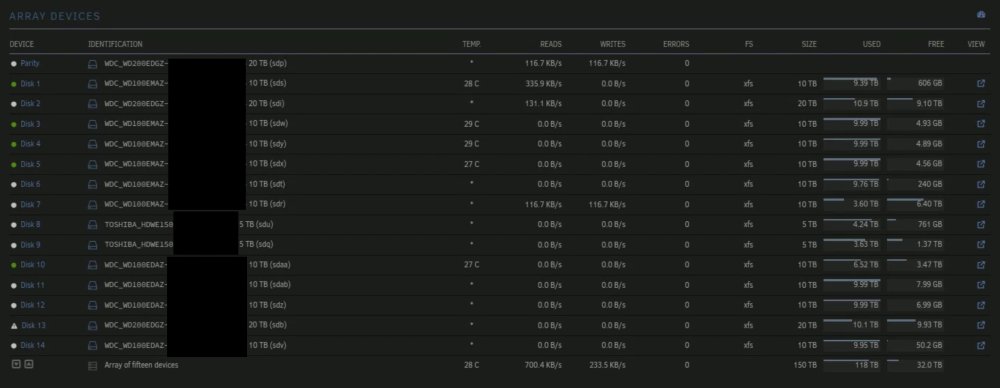

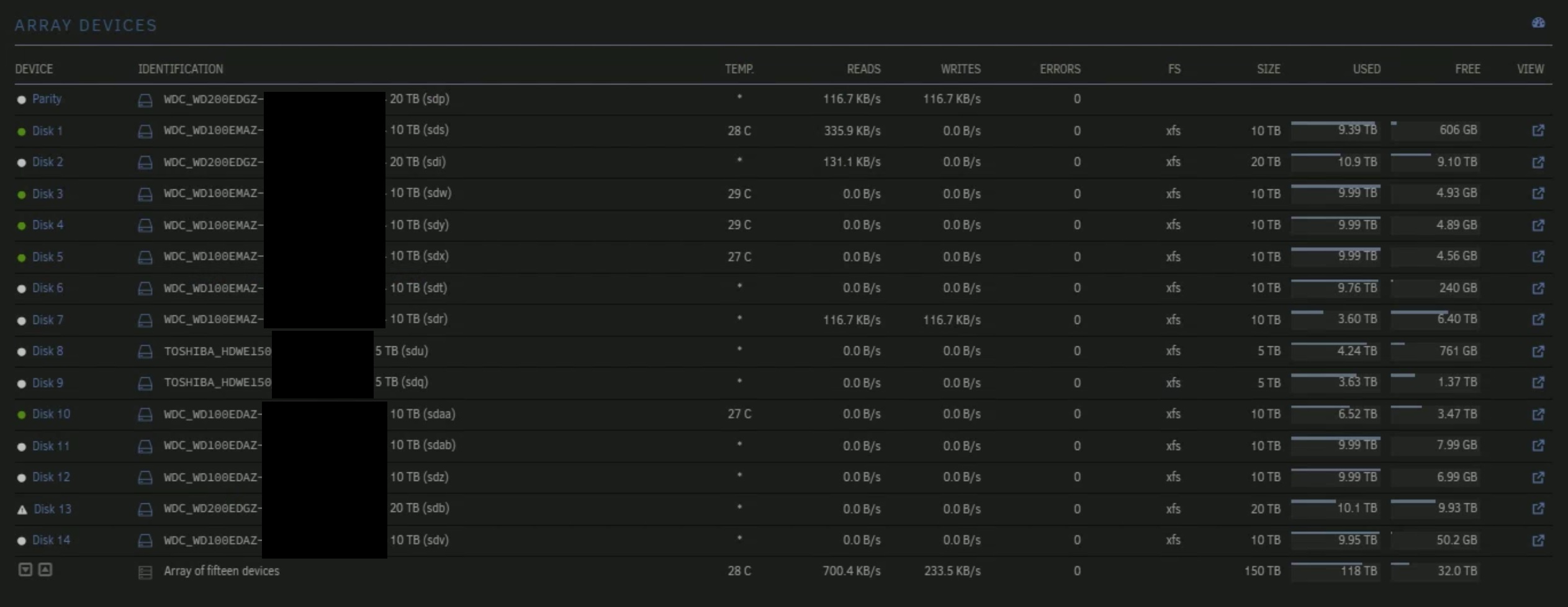

Do you mean read errors? Not seeing any on the diags posted, but they are shortly after a reboot.
I dont want to start the data rebuild until I have something I can change and test, because it does not complete and the array stops somewhere between 1hr and 20hrs into the rebuild.
But the Dashboard section will show errors during a rebuild, and the Main section will show errors on multiple drives...after a reboot those numbers are reset, and I don't see errors in the logs for those disks. (I attached images of these sections, they show 0 because its after a restart and I paused the rebuild immediately upon reboot)
What do you suggest I can try before I try another rebuild?
Without seeing the actual errors difficult to say, but most likely power/connection issues.
Looks more like a power/connection problem.

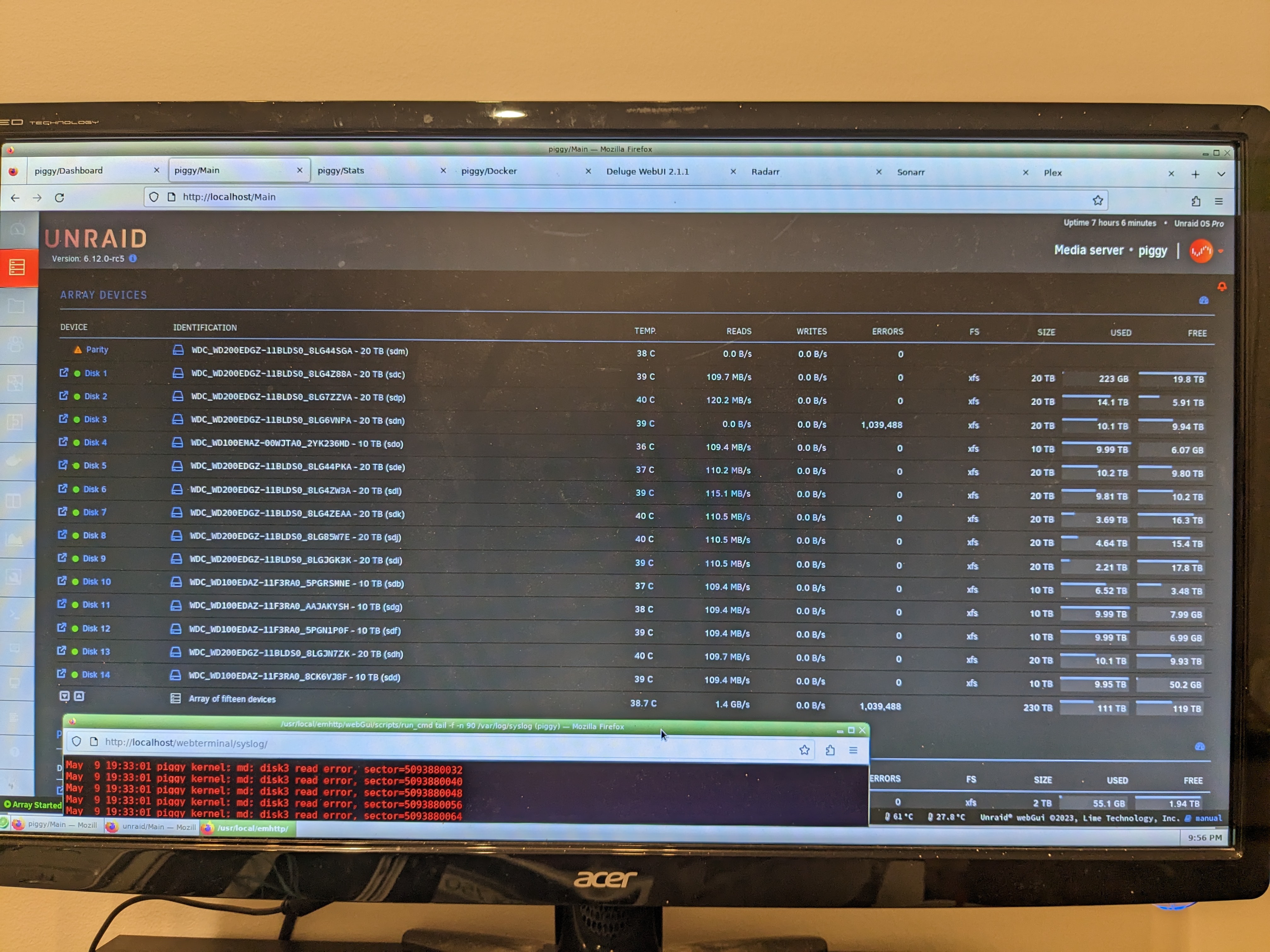

Random docker soft crashing during data-rebuild, unraid gui works fine, cpus get pegged when the docker applications soft crash.... It really feels like something else is causing this to happen, but what else can I test?
I've reduced the number of wires by moving the case close to the drives.  Now from the motherboard, I have 2x LSI 9217-8I connected directly to the harddrives with 4x SFF-8087 to 4xSATA Forward Breakout 1.6ft
I have 9 drives swapped, working on number 10. But this one keeps stopping around 30-35% locking up the docker containers, preventing me from stopping or restarting docker applications.

I got this error message today....what does it mean"
Apr 30 02:12:49 piggy kernel: python3[24762]: segfault at 14bf167330 ip 000014bf1642763c sp 00007ffd3b138580 error 4 in libpython3.11.so.1.0[14bf162ee000+223000]
Apr 30 02:12:49 piggy kernel: Code: a8 00 00 00 01 e9 2b d5 ee ff 0f 1f 40 00 41 54 55 53 48 89 fb 48 83 ec 10 48 8b 57 f0 48 85 d2 0f 84 08 02 00 00 48 8b 7f f8 <4c> 8b 42 08 4c 8d 15 d9 ff ff ff 4c 8b 4b 08 48 83 e7 fc 41 83 e0
Other than the fact it is python3 crashing I suspect you are unlikely to get much help from Unraid users as python is never part of a standard install (as far as I know).

Parity made it 13% then disk 3 created 1million errors. Disk 3 is new, has had 2x preclear cycles and has been installed for months with no issues.
Syslog went from 200k to 4gb
Is it my 2x  lsi 9217-8i controllers?
Looks more like a power/connection problem, replace/swap cables and try again.
I swapped the sata power cable with a known good cable, had the same exact result as before.
