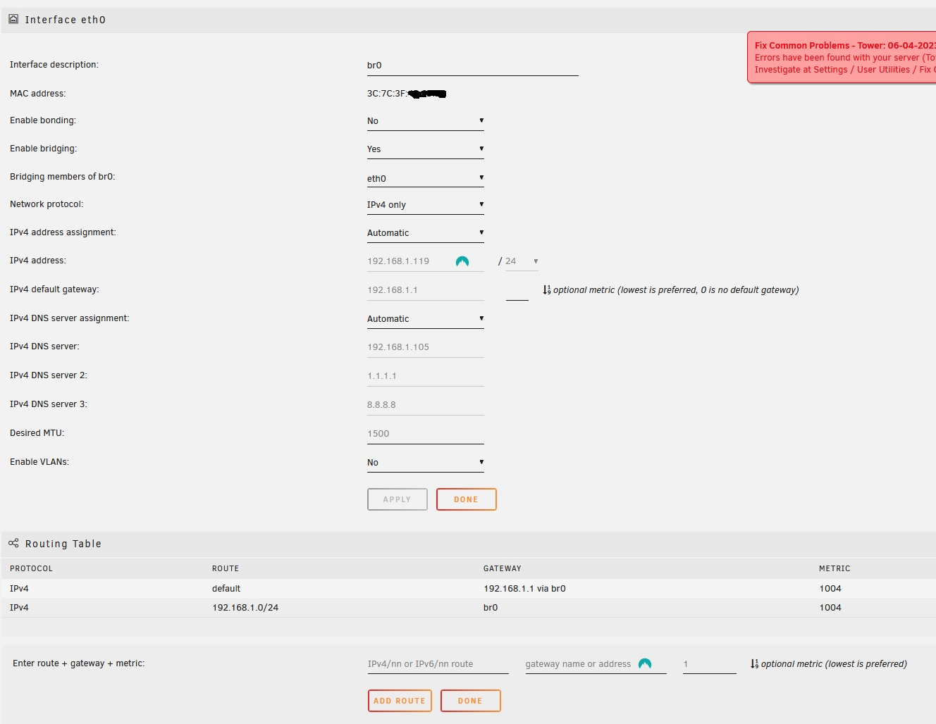

I've now tried what you suggested, found the setting in the BIOS that disabled the onboard LAN, and booted back into Unraid.  But now it seems I've got another problem, well two in fact, but unrelated.
The first problem I have is that when Unraid boots, the last thing the boot process shows is the IP v4 and IPV6 addresses.  Well sometimes it correctly shows 192.168.1.119, but sometimes it incorrectly shows 169.254.194.X (last number purposely deleted) OR even "not set"  In the first two cases I can login to the GUI with 192.168.1.119 though.  In the first case the server works relatively ok and I have access to my plugins etc (could update them).  In the second case, I do not.  In the third case, I can't even login.  I have no idea what is causing this and it seems random.
Fix common problems says : "eth0 and eth1 both have IP addresses on the 192.168.1.0 network."  But in network settings I can only see Eth0, which is called Br0.  I see no Eth1 ??  "Ifconfig" in a terminal window also only shows "Br0", "Eth0" and "Lo".  I have no idea what is going on here, I'm not very Linux savvy.
This is what Network setup now shows:

For the first problem I would suggest deleting the config/network.cfg file from the flash drive and rebooting to get a new default one generated as it looks as if there are remnants of when you had 2 active NICS in there.

The network issues seem to have been fixed too with the deletion of the "network.cfg" file.
