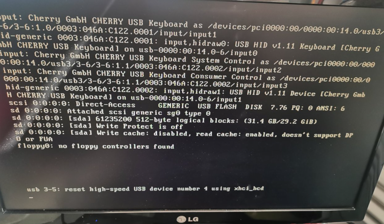

My USB Stick crashed and i bought a new one, installed the latest Backup(unfortunatly it is half a year old) with the USB Creator and replaced it.
The thing is, UNRAID doesnt start properly.
The Startup-process comes up (where i can chose to run safe mod and stuff) then it seems to start, but it always stops eventually.
See Image attached.
Cant get it to work, it will always stop there.
I already tried a complete new installation on the stick without backup.
Even that doesnt work.
I also tried to copy the raw Data from my Backup to the Stick and ran the Make bootable, but that didnt work either.
Someone have a clue what is goin on?
Try a different flash drive.
That did it! Thx
WTH, that Stick is brand new, and it works fine as a simple USB Stick in Windows.
What caused this? How did u know?
