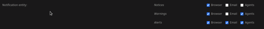

If you setup your Unraid notification correctly, you should have received an email for every error line.
i think it is, because i got error notification via email/telegram/gui for other errors.

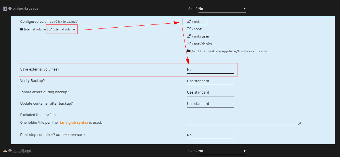

On 7/23/2023 at 6:35 PM, KluthR said:
You excluded /mnt for Krusader resulting in failing verification. Please remove the exclusion or skip the whole container.
On 7/18/2023 at 1:42 PM, LoyalScotsman said:
Probably a silly question, but would removal of the exclusion cause backing up /mnt too?
no, because of this:
image.thumb.png.05b55e79810164b67cdaab3f49e5aa29.pngimage.thumb.png.bd8adfc0640d11cc88478dd3a7807ef9.png
Edited by sonic6

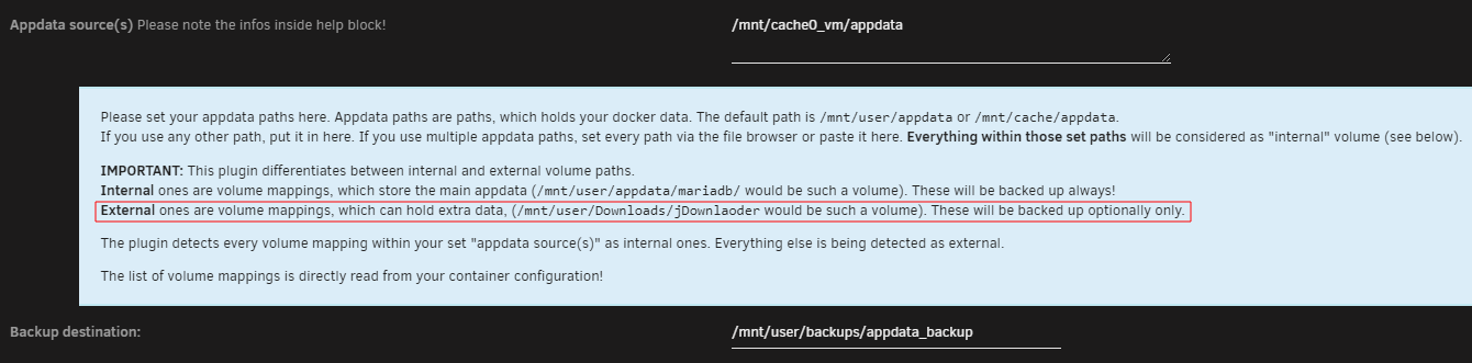

On 6/24/2023 at 9:01 AM, jcofer555 said:
how do i backup the actual appdata like the old plugin? when i do a backup all i get is the .xml files
I I have the same issue... I a glad i saw it before i ru into an issue and then having no recent backup.. do you already know how to fix it?
@quiksilver2 and @jcofer555 Please share the debug log or the view for Internal volumes of the container sections. It feeld like all volume mappings are treated as external because incpmplete Appdata sources configuration. Note the help block for that field.
my issue is resolved after figuring out which volumes i needed to select and which to deselect, a much more cumbersome process. though i guess being able to backup more things can be a good thing :)

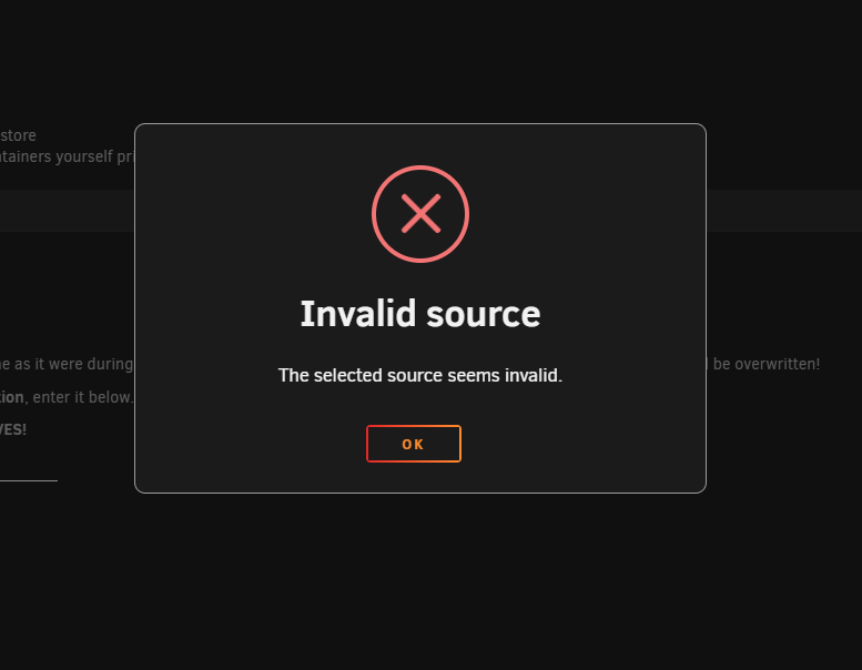

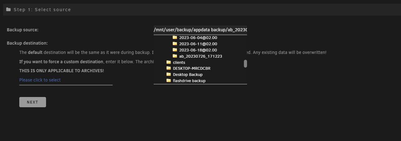

I'm getting a invalid source error. I made a backup of my appdata and it appears to have been successful. I've attached the debug log from the backup. When I try to restore from that exact same backup I get the invalid source error. I am not trying to restore my appdata from the old plugin, you can see in the first image I am selecting the ab_ folder.
ab.debug.log
