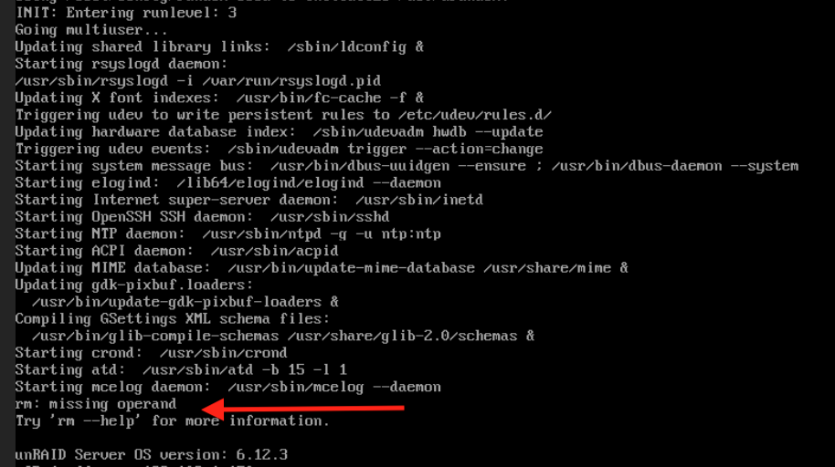

Hello,
Good team, I would like to report an error that I have detected when you install the plugin and the system starts. I get a message indicating that the rm command is executed but without arguments.
I leave a screenshot to make it easier to see it. I have tried to uninstall the plugin and the error disappears, when I reinstall it appears again.
Great job with this plugin and thanks.
Best regards.
Never noticed it, I'll check this, thanks!

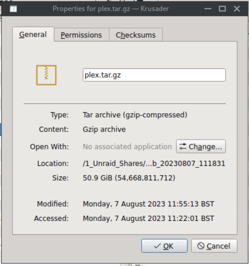

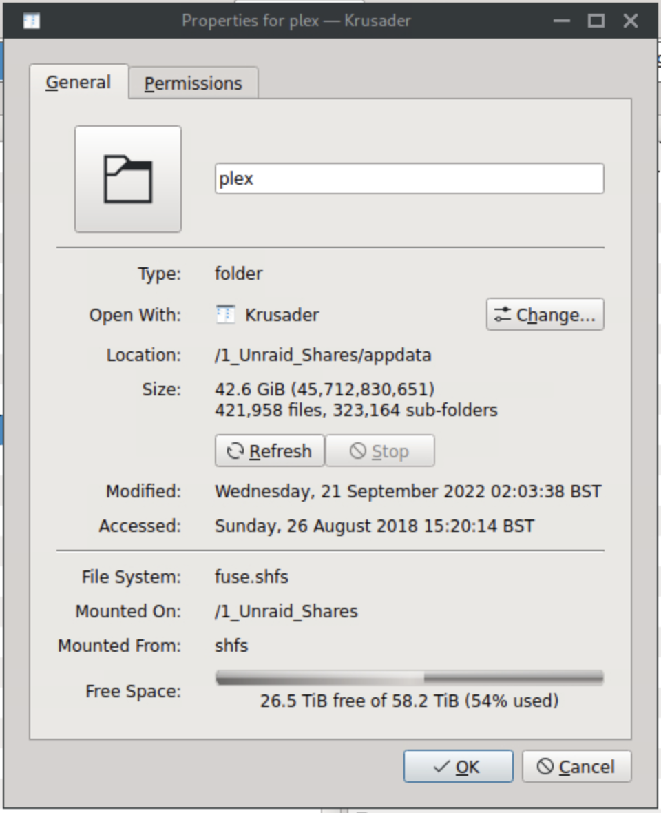

I have just got round to moving from ca.backup2 to this plugin, thanks very much for taking over.
In my first backup, Plex took 30 minutes to backup and then 30 minutes to verify, and the output file is 50GB compared to the Plex appdata folder being 25GB.
Everything else seemed to go smoothly, but the slow speed and huge size of the Plex backup has me concerned. Do you have any ideas?
ab.debug.log ab.log
Not sure. The backup only picks up /mnt/user/appdata/plex which seems correct. And that folder ist 25GB compared to 50GB for the plex.tar.gz??
Ah, it seems as though Krusader was just being very slow to calculate the Plex folder size - it now says that Plex is 42.6GB compared to 50GB for the plex.tar.gz. Perhaps that is normal? Screenshots attached.

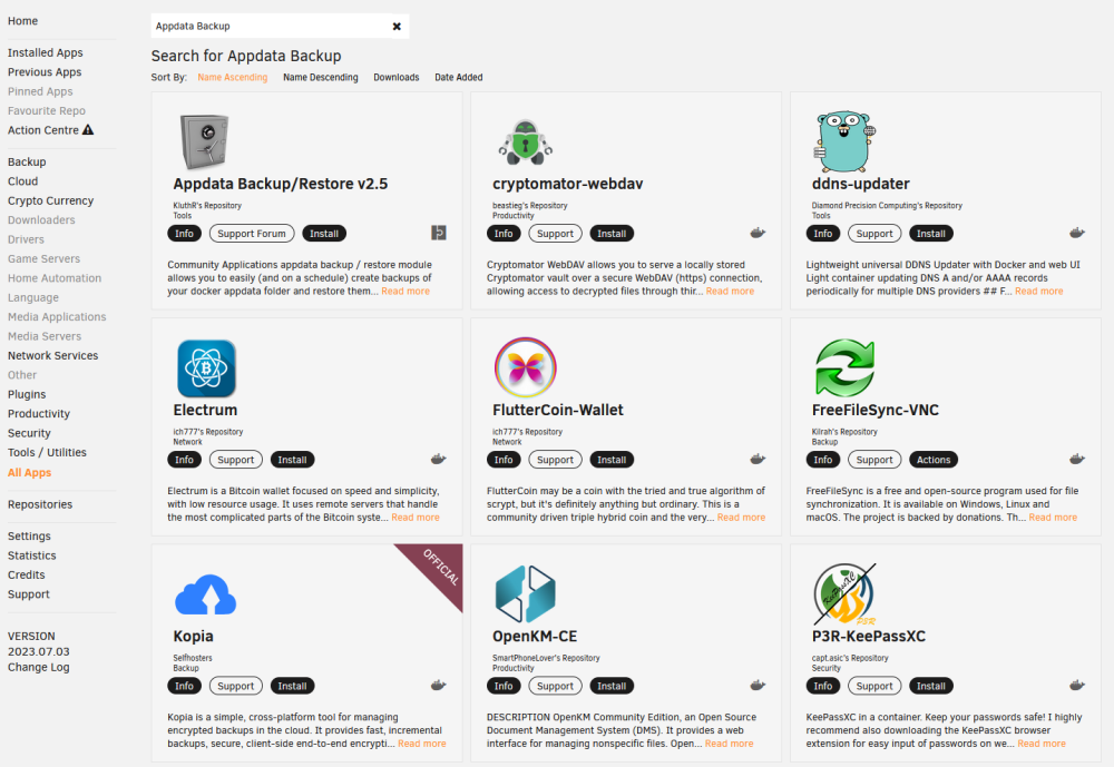

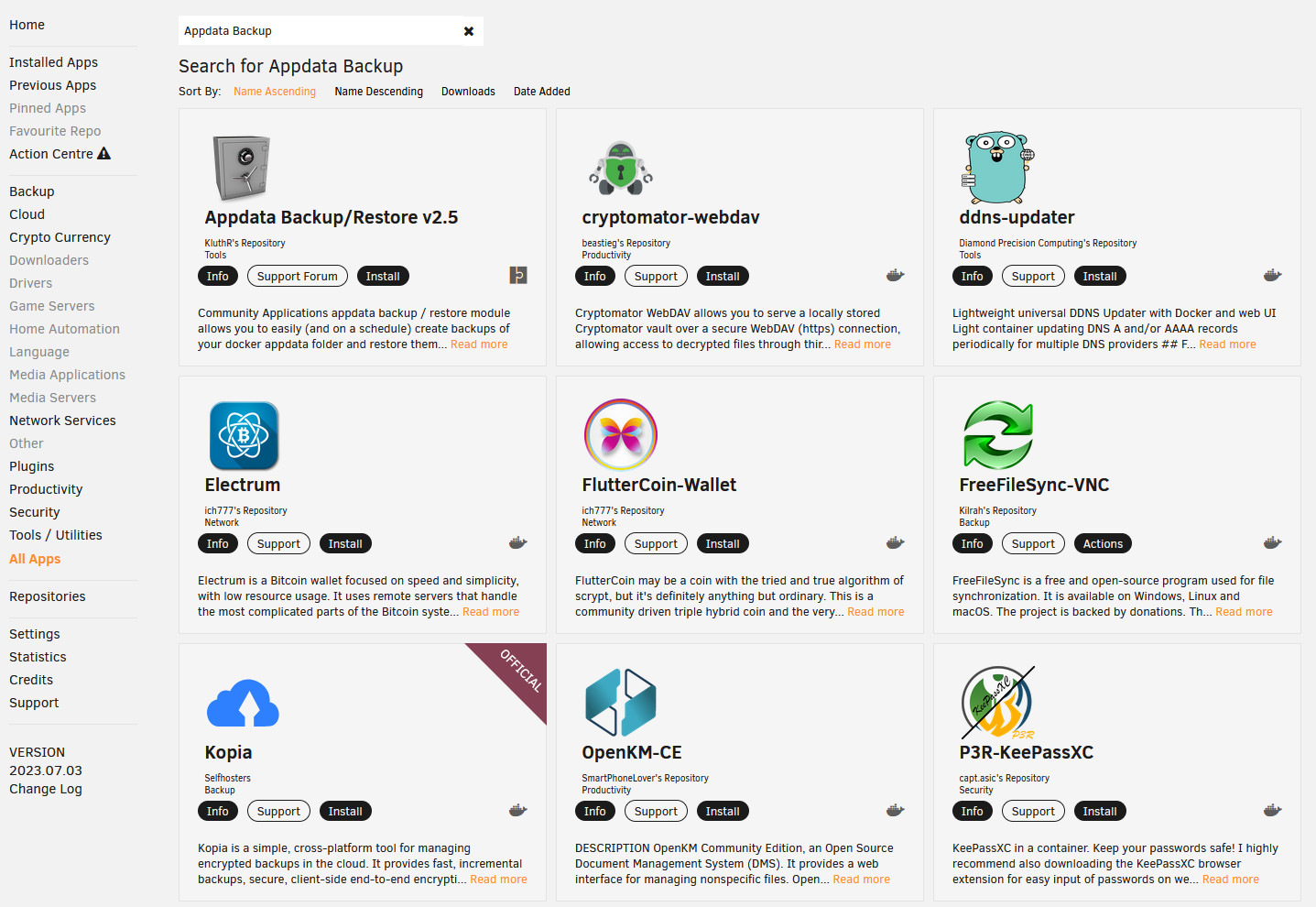

I just uninstalled Appdata Backup/Restore v2.5, I tried to install the new version but not found ? Am I blind or unRAID 6.12 version is needed ? 😅 I'm on unRAID 6.11.5
Edited by Alex.b
This
I found out that it is.
You will not find the new "Appdata Backup" if you are on anything below "6.12". and it is also the other way, you will not find the Appdata Backup/Restore v2.5 on anything above "6.12".
