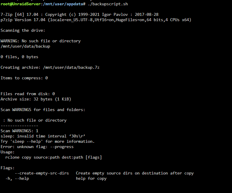

rogales Posted November 15, 2023 Share Posted November 15, 2023 (edited) Thank You for Your answer. I have just one more question, about this great plugin, mainly, what kind of "format" should be script that I can attach to this plugin? I have something like this: #!/bin/bash 7z a -bsp1 -ppassword /mnt/user/data/backup.7z /mnt/user/data/backup sleep 30s rclone copy /mnt/user/data/backup.7z backup:/backup --progress sleep 30s rm -r /mnt/user/data/backup/* sleep 30s rm /mnt/user/data/backup.7z exit 0 and I would like to start this process after backup is done. Edited November 15, 2023 by rogales Quote Link to comment
KluthR Posted November 15, 2023 Author Share Posted November 15, 2023 That script looks good to me. At least it would run. Quote Link to comment
rogales Posted November 15, 2023 Share Posted November 15, 2023 5 minutes ago, KluthR said: That script looks good to me. At least it would run. it works - when I put it in User Scripts plugin, but i don't know how (im kinda new to linux etc) how to save (which format should i use of the file of the script) and where should I put it. That's my problem. Quote Link to comment
KluthR Posted November 15, 2023 Author Share Posted November 15, 2023 Just save it with some name without extension (or with .sh) somewhere (not on the boot device!) Make it executable with „chmod +x myscript.sh“ and set the it as script inside plugin. Quote Link to comment
rogales Posted November 15, 2023 Share Posted November 15, 2023 (edited) I've already tried with .sh and it doesn't work. so I've edited, and delete the "#!/bin/bash" and saved it. after that I have this error: Edited November 15, 2023 by rogales Quote Link to comment

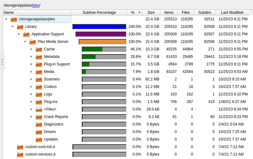

ConnerVT Posted November 20, 2023 Share Posted November 20, 2023 (edited) The only thing I exclude is my cache. It cuts my appdata backup for Plex in half - both in the size of the Plex appdata backup and in total time to backup 34 dockers. Cache = 11.7 GB Everything else (for Plex) = 13.5 GB /mnt/cache/appdata/plex/Library/Application Support/Plex Media Server/Cache/ Edited November 21, 2023 by ConnerVT Added sizes 1 Quote Link to comment

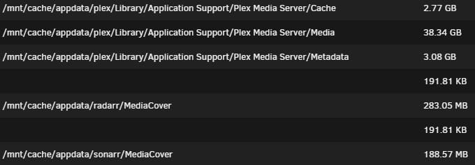

Renegade605 Posted November 25, 2023 Share Posted November 25, 2023 On 11/20/2023 at 12:23 PM, KluthR said: I asked long ago that all plex users should share their working exclusions so I can recommend some I've since switched to using ZFS snapshots instead of this plugin, but here's my exclusion list: Cache excluded on the basis that it's meant to be temporary anyway, all others because they are easily and automatically re-downloaded/-generated if lost. Quote Link to comment
ConnerVT Posted November 26, 2023 Share Posted November 26, 2023 (edited) Interesting how your Plex appdata usage is so different than how mine is distributed. Edited November 26, 2023 by ConnerVT Quote Link to comment
