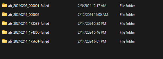

[14.02.2024 17:56:20][ℹ️][radarr-nime] Starting radarr-nime is being ignored, because it was not started before (or should not be started).
[14.02.2024 17:56:20][ℹ️][radarr] No stopping needed for radarr: Not started!
[14.02.2024 17:56:20][ℹ️][radarr] Should NOT backup external volumes, sanitizing them...
[14.02.2024 17:56:20][ℹ️][radarr] Calculated volumes to back up: /mnt/user/appdata/radarr
[14.02.2024 17:56:20][ℹ️][radarr] Backing up radarr...
[14.02.2024 17:56:37][][radarr] tar creation failed! Tar said: tar: /mnt/user/appdata/radarr/logs/radarr.24.txt: File shrank by 995287 bytes; padding with zeros; tar: /mnt/user/appdata/radarr/logs/radarr.21.txt: File shrank by 1011456 bytes; padding with zeros; tar: /mnt/user/appdata/radarr/MediaCover/128/fanart.jpg: Read error at byte 20480, while reading 10240 bytes: Input/output error; tar: /mnt/user/appdata/radarr/MediaCover/154/fanart-180.jpg: Read error at byte 0, while reading 6656 bytes: Input/output error; tar: /mnt/user/appdata/radarr/MediaCover/166/fanart-360.jpg: File shrank by 62211 bytes; padding with zeros; tar: /mnt/user/appdata/radarr/MediaCover/169/fanart.jpg: File shrank by 803138 bytes; padding with zeros; tar: /mnt/user/appdata/radarr/MediaCover/172/poster.jpg: File shrank by 1513292 bytes; padding with zeros; tar: /mnt/user/appdata/radarr/MediaCover/321/poster-500.jpg: File shrank by 66810 bytes; padding with zeros; tar: Exiting with failure status due to previous errors
[14.02.2024 17:56:38][ℹ️][radarr] Starting radarr is being ignored, because it was not started before (or should not be started).

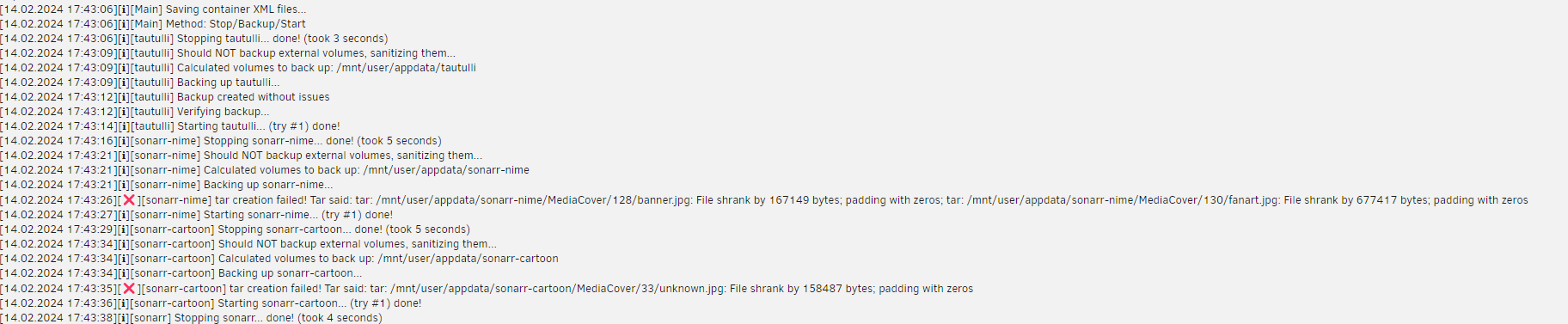

i keep getting this error and want to restore from this failed backup appdata. is there any problem will occur later?

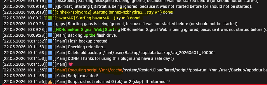

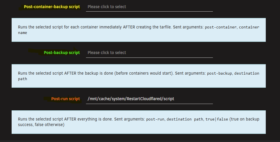

Is it normal, that script attached as a Post Run Script is not listed in LOG text, but it's running in the background?
I have scheduled backup with .sh script which packs and upload my backup to a different server (using rclone copy mode).
It's scheduled every 1st and 15th of the each month.
1st of the February worked perfectly, and the information about whole process was written in the LOG of the plugin, but today it seemed to work in the background without any logs?
Any changes in the newst version of the plugin? (im up to date)

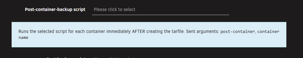

Question on the post run script here too.
From the help:
"Runs the selected script AFTER everything is done. Sent arguments: post-run, destination path, true|false (true on backup success, false otherwise)"
Are these positional arguments being sent?
So:
$1="post-run"
$2="/path/to/where/appdata_backups/puts/the/backups/" # Is there a trailing slash or no?
$3="true OR false"
No changes here. The plugin waits until the executed script is done and checks its exit code.
Yes
Erm... *reads the source code* No, no trailing slash!

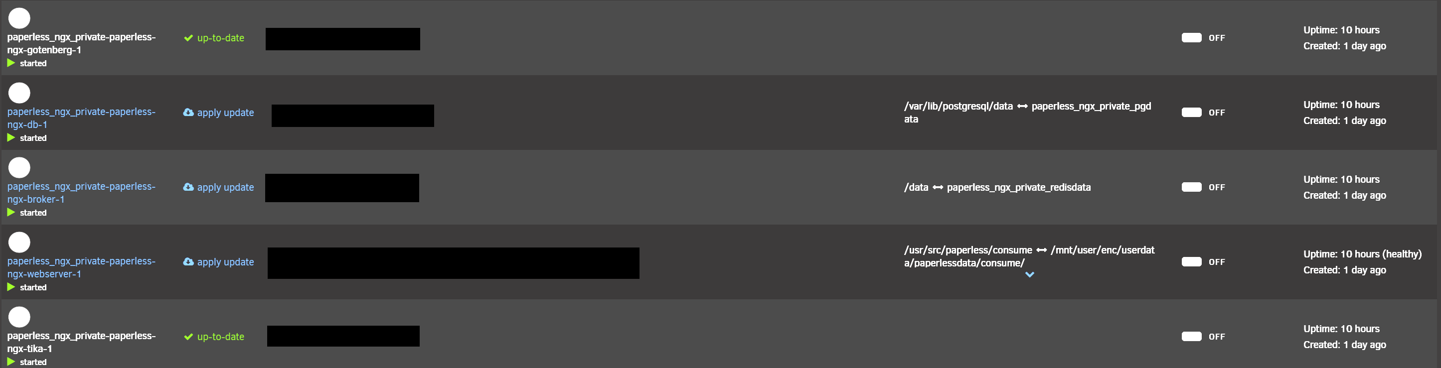

Thank you for a rework on the appdata plugin. I seem to have problems with named bind volumes from the docker compose plugins.
First of all, this is the error from the debug log:
[17.02.2024 03:06:28][][paperless_ngx_private-paperless-ngx-broker-1] 'paperless_ngx_private_redisdata' does NOT exist! Please check your mappings! Skipping it for now.
[17.02.2024 03:06:39][ℹ️][paperless_ngx_private-paperless-ngx-broker-1] Should NOT backup external volumes, sanitizing them...
[17.02.2024 03:06:39][⚠️][paperless_ngx_private-paperless-ngx-broker-1] paperless_ngx_private-paperless-ngx-broker-1 does not have any volume to back up! Skipping. Please consider ignoring this container.
[17.02.2024 03:06:39][][paperless_ngx_private-paperless-ngx-db-1] 'paperless_ngx_private_pgdata' does NOT exist! Please check your mappings! Skipping it for now.
[17.02.2024 03:06:50][ℹ️][paperless_ngx_private-paperless-ngx-db-1] Should NOT backup external volumes, sanitizing them...
[17.02.2024 03:06:50][⚠️][paperless_ngx_private-paperless-ngx-db-1] paperless_ngx_private-paperless-ngx-db-1 does not have any volume to back up! Skipping. Please consider ignoring this container.
[17.02.2024 03:06:50][ℹ️][paperless_ngx_private-paperless-ngx-gotenberg-1] Should NOT backup external volumes, sanitizing them...
[17.02.2024 03:06:50][⚠️][paperless_ngx_private-paperless-ngx-gotenberg-1] paperless_ngx_private-paperless-ngx-gotenberg-1 does not have any volume to back up! Skipping. Please consider ignoring this container.
[17.02.2024 03:06:50][ℹ️][paperless_ngx_private-paperless-ngx-tika-1] Should NOT backup external volumes, sanitizing them...
[17.02.2024 03:06:50][⚠️][paperless_ngx_private-paperless-ngx-tika-1] paperless_ngx_private-paperless-ngx-tika-1 does not have any volume to back up! Skipping. Please consider ignoring this container.
[17.02.2024 03:06:50][][paperless_ngx_private-paperless-ngx-webserver-1] 'paperless_ngx_private_data' does NOT exist! Please check your mappings! Skipping it for now.
[17.02.2024 03:07:00][][paperless_ngx_private-paperless-ngx-webserver-1] 'paperless_ngx_private_media' does NOT exist! Please check your mappings! Skipping it for now.
[17.02.2024 03:07:11][ℹ️][paperless_ngx_private-paperless-ngx-webserver-1] Should NOT backup external volumes, sanitizing them...
[17.02.2024 03:07:11][⚠️][paperless_ngx_private-paperless-ngx-webserver-1] paperless_ngx_private-paperless-ngx-webserver-1 does not have any volume to back up! Skipping. Please consider ignoring this container.
The volumes mentioned in the error log are named volumes in docker compose template files. This is necessary, because they are used in different containers in the template:

When running the docker compose template, the Unraid docker overview shows them like this:
I therefore assume, the appdata plugin tries to pickup the mapping that Unraid provides in the overview instead of the mapping defined in the docker compose.
To avoid the errors, I will exclude the containers now from backups.
I was wondering: is there a stable and better way in the plugin to deal with docker compose named volumes?
Thank you in advance!
You should simply not use named volumes. Nothing on unraid is designed to work with that.

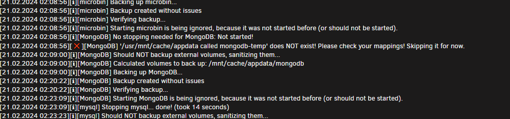

On 2/16/2024 at 7:14 AM, KluthR said:
The mentioned folder does not exist on Unraid side, maybe (as its a tmp folder) you want to exclude it?
Ya know I never realized you could do that. Added to the exclusion list. Thanks!

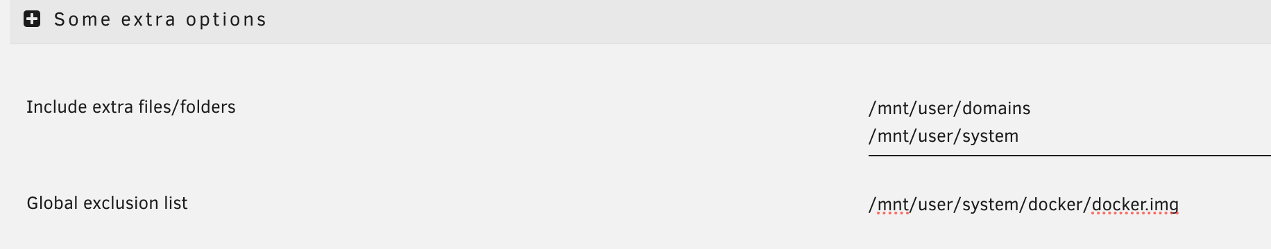

Running Appdata Backup with "stop all containers, backup, start" and I'm getting this error in the log:
[Main] tar creation failed! Tar said: tar: /mnt/user/system/docker/docker.img: file changed as we read it
I'm not sure what to do here since everything is stopped.
Shared Debug Log as 9e627b20-3451-48f4-982d-c6e39fc17a20
Normally you wouldn't back that file up. It's not supposed to contain any of your customized data.
Pardon me if I missed it; recently this has started throwing a "alert." It has not always done this; sent a alert on this. I guess I am too stupid to understand it - but is this actually an issue or what does it mean? Did something change and this has been always been an "issue" but wasn't' alerted to it?
Thanks!  It looks like it came along because I specified /mnt/user/system/ as part of the backup. I've added it to the global exclusion section.
It looks like that didn't work as I expected. I was hoping it would just exclude that file.
What I'm attempting to do is also backup the system file since I only have one cache drive.
On my system it looks like only that file exists there so perhaps it not necessary to backup system then.
