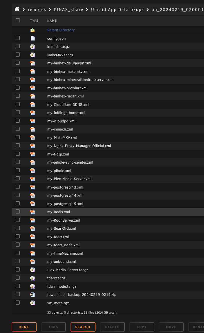

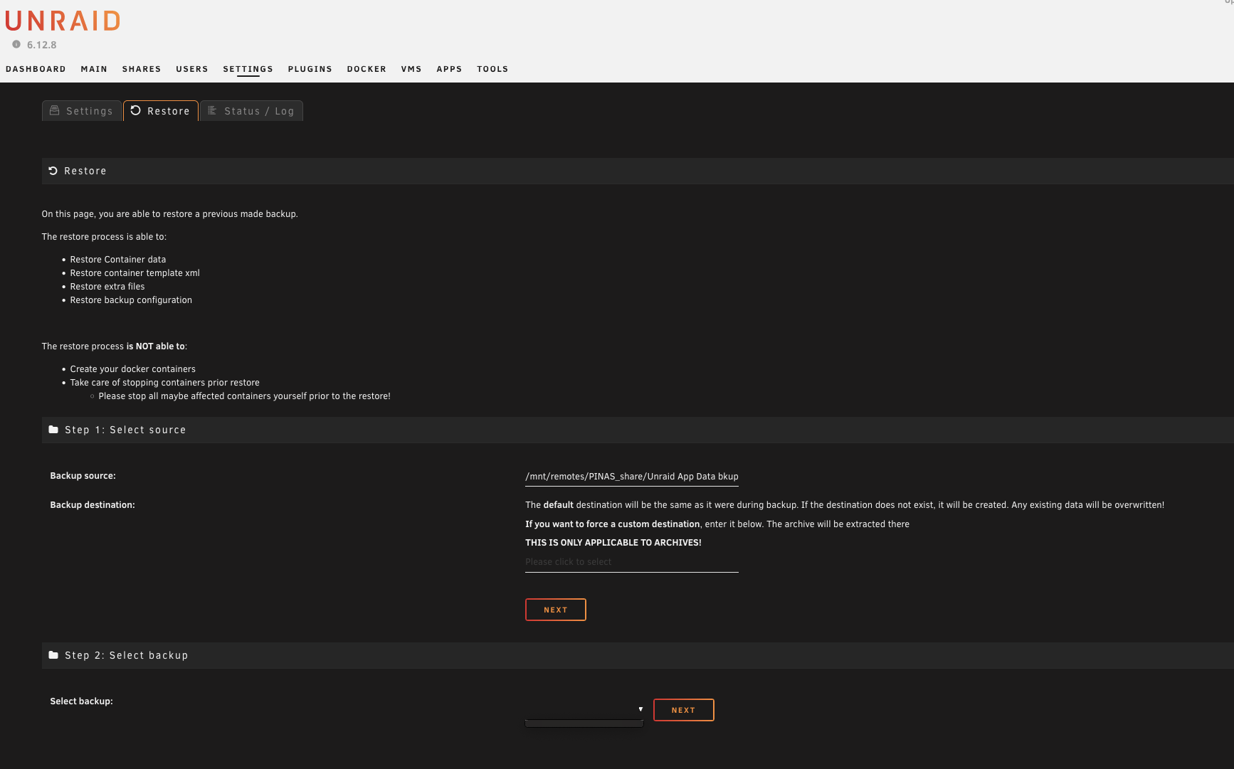

13 hours ago, Beardiful42 said:
Need to try and restore a container.  When I go into the restore section it has my backup location.
Did you set the directory containg the ab_ directories or did you selected it directly? the 1st way should be working.
14 minutes ago, daithi said:
Last night I got an error on 4 of my containers (about 1/4)
Please check the displayed volumes in the settings page. If all all marked external, consider to ignore the container.
I am not sure I follow,  The directory that is populated that matches the location that I backup too populates automatically.   You can see in the picture the step two has a drop down that contains nothing.  But I can physically go to the location and see all my backups.  I thought maybe it was FireFox so I tried Chrome and didn't make a difference.
Please show the contents of the pre-filled directory path (via terminal or via file browser). Are the ab_ folder inside?

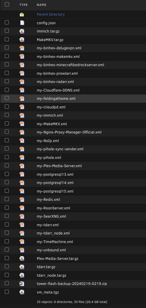

473266019_Screenshot2024-02-23at4_59_58PM.thumb.png.6dc0205cd24d64e7a3a653a364fa6819.png
I believe this is what you are asking for.  I find it strange that there are container backups for containers I am no longer run.  Not sure why that is either.  Thanks for the help!

When attempting to restore appdata, I get an error: Invalide Sourec - The selected source seems invalid.  I'm likely missing something obvious, but I cannot figure out what.  Below is my log file number.  Thank you for your help
2605837a-0e1d-4638-a6d5-7101d2336d12
No, Iam talking about the folder that holds the ab_ folders.
Did you selected the folder that holds the ab_ folders?
