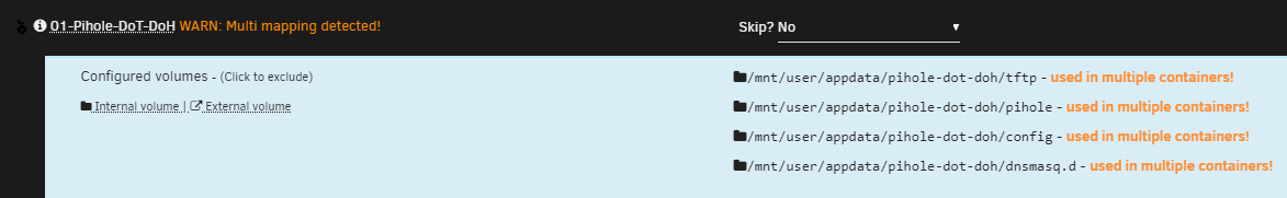

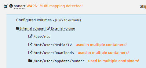

With the current version in the UI I get the "WARN: Multi mapping detected!" for almost all my containers, most of them being actually unique.

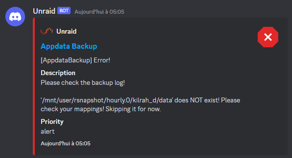

Also I got an error for a missing folder. That is an external volume, and external volumes are not being backed up for this container, so that should at most be a warning, not an error.
Hmm. Need to check tomorrow. As well as the second issue you posted.
 Seeing the same in all of my containers except 3.  Those have no appdata configured.
