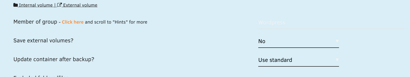

I just noticed the grouping functionality but when I double click the field where is says 'None - Double click for a list'
Yea, if you initially have NO groups set at all, there will be no list. Some kind of misleading here. Just type something in and you will have a list for any other container now.
Can you confirm that?
Thank you! That makes sense. It's working.

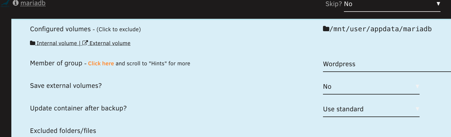

1 minute ago, FUser said:
but on a dark colored theme
I dont test on anything but the default theme. Could you please post a screenshot? I can try to make the color better for non-light-themes.
Please let me know if you need a larger view of what I'm seeing.
Yea just cinformed that by changing it at my end just for you :)
Will be fixed in next update!
