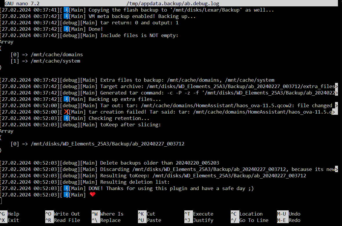

4 hours ago, KluthR said:
Have a look into the debug log file at the last few lines (/tmp/appdata.backup/ab.debug.log)
I can see it their neither:

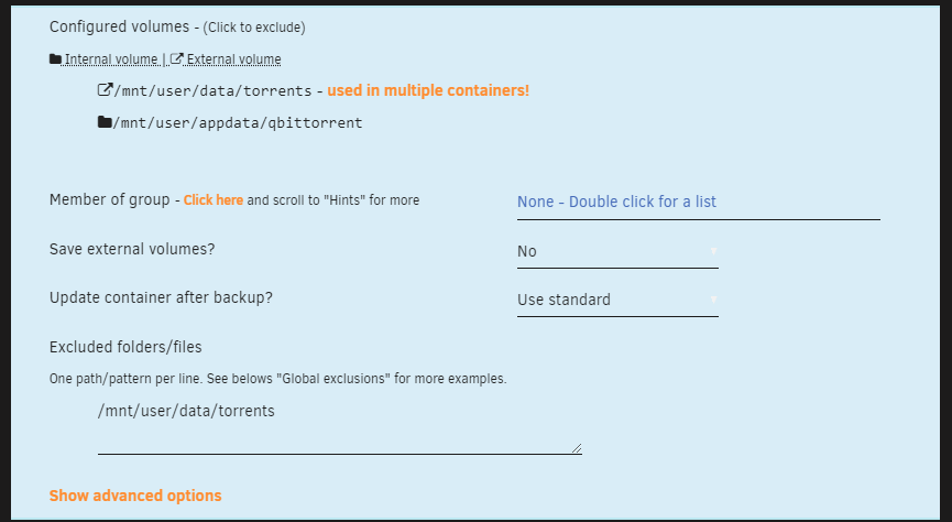

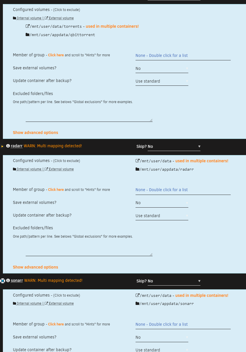

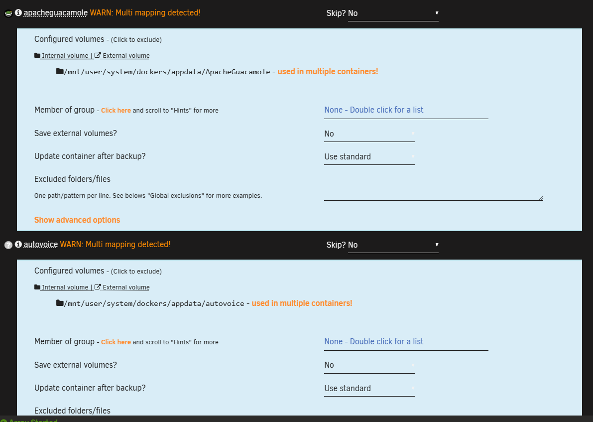

having the WARN: Multi mapping detected! message in all my containers even though the paths are different. this is the newest version 2024.02.26image.thumb.png.aab6d8d6079baa7e7c398872658e6481.png
Is it possible to just run a bash command instead of a script file?
Known an I (we) are on it. Currently collecting debug info from affected users as I cant reproduce it on my end.
Uh Oh. Doesnt look right at all! I guess something is crashing silently. If the red heart is definitively the last line in that log, er are having an issue here. If you have some time, please PM me, I also need some testst at your side for me to understand this.

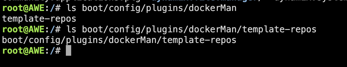

A couple of questions:
If I'm doing a new unraid build and using the flash disk zip file to create a new unraid usb boot drive. Will that fire up the array as it was? (don't want that) If so, is there a way to stop it from starting the array as soon as it starts?
Secondly: I've never done a restore but I'm in a pickle and may need to do a restore on a fresh new build. How would one go about it? Restore the docker backups and then install the containers?
So I just did a restore, selected all templates and containers (did not select "restore backup config") and instantly got all the appdata in the mnt/user/appdata! Great!
But when I go to Apps, I can't see any dockers in Previous Apps. Any idea how to get them back? As that's really the main thing about these backups. so that the templates are as they were.
1152147761_CleanShot2024-03-03at00_16.48@2x.thumb.png.44169b846151999de2f316daf90dac40.png
This is a new installation. So where did the templates get restored to?!
Edited by Sptz87
Previous Apps gets the templates from /boot/config/plugins/dockerMan/templates-user
But since this a new installation it doesn't exist. And doing a restore I thought it'd copy them into that folder? Otherwise what's the point of restoring?
Should I create that folder and attempt a restore again?
Solved: In case anyone is in the same situation. Just installing any random container from the "appstore" obviously created that folder. Then once you restore it again it will be able to populate. Since it looks like this plugin isn't attempting to create the folder if it's missing, just populate it.
Edited by Sptz87

On 4/10/2023 at 10:22 AM, KluthR said:
The plugin sent me here to get help for the "Mapping used in multiple containers!" message
The plugin can detect if you use the same mapping within more containers. That is completely okay but you should know that this can lead to "verification failed: contents differ" messages if you use stop/backup/start method and another container modifies the data during backup of the container that uses that share.
The best way to get rid of that message is to add that share to the exclusion in all but the main container. One could also change the backup type but it does not prevent backing that share up multiple times!
I do not think I am fully understanding this. So I am getting the multiple containers warning.
I am trying to understand the remedy for this. So basically this is saying one file is pointed multiple times and will be backed up multiple times? Since I have the /mnt/user/appdata added to the appdata sources.
I just exclude the file path in each container?
Known bug.  He's working on it.
