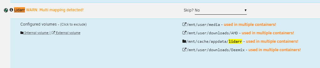

Nearly every single container is telling me there's a shared mapping, is this normal? It doesn't seem right.
Lidarr's appdata for example isn't mapped anywhere else
Look a couple days back in this thread. It's mentioned and there is a hot fix.

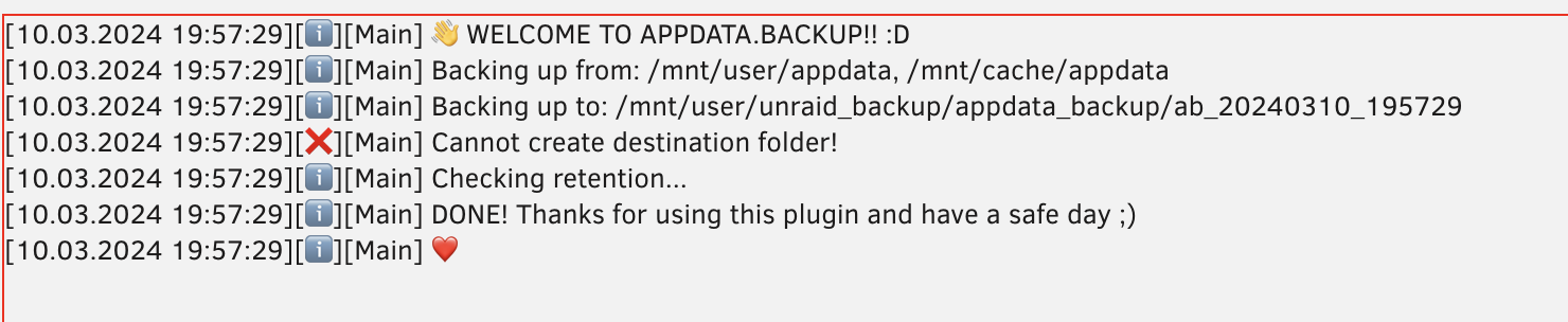

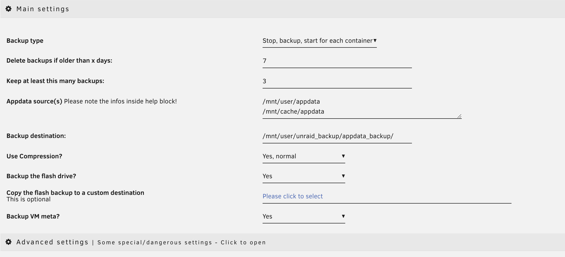

I keep running into an error, cannot create the destination folder. Not sure what could be causing the issue. Any help would be appreciated!
Interesting. Is there something special about /mnt/user/unraid_backup ?
Whats happening if you run "mkdir /mnt/user/unraid_backup/appdata_backup/test"?
When I went to run that command, it failed with an error of not having enough space, this lead me to investigate the minimum free space setting of the share. Once I corrected that issue I was able to run the backup successfully!
Thank you for pointing me in the in the right direction!
