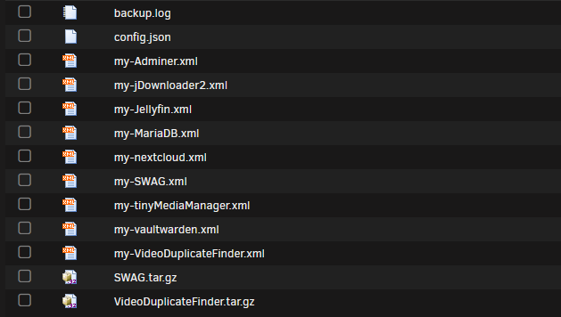

Hello,
I am wondering wether I have the plugin configured wrong.
This is what my source and destination look like.
Everything else I have left pretty much as it was by default.
Now, after I run the manual backup once I feel like there should be a tar.gz file for each docker container, am I wrong here? I can only see two compressed files.
This is the log file of the manual backup:
[15.06.2023 20:15:05][Main][info] 👋 WELCOME TO APPDATA.BACKUP!! :D
[15.06.2023 20:15:05][Main][info] Backing up to: /mnt/user/backup/ab_20230615_201505
[15.06.2023 20:15:05][Main][info] Saving container XML files...
[15.06.2023 20:15:05][Main][info] Method: Stop/Backup/Start
[15.06.2023 20:15:05][Adminer][info] No stopping needed for Adminer: Not started!
[15.06.2023 20:15:05][Adminer][info] Should NOT backup external volumes, sanitizing them...
[15.06.2023 20:15:05][Adminer][info] Adminer does not have any volume to back up! Skipping
[15.06.2023 20:15:05][Adminer][info] Adminer is being ignored, because it was not started before (or should not be started).
[15.06.2023 20:15:05][jDownloader2][info] No stopping needed for jDownloader2: Not started!
[15.06.2023 20:15:05][jDownloader2][info] Should NOT backup external volumes, sanitizing them...
[15.06.2023 20:15:05][jDownloader2][info] jDownloader2 does not have any volume to back up! Skipping
[15.06.2023 20:15:05][jDownloader2][info] jDownloader2 is being ignored, because it was not started before (or should not be started).
[15.06.2023 20:15:05][Jellyfin][info] Stopping Jellyfin...
[15.06.2023 20:15:05][Jellyfin][info] done! (took 0 seconds)
[15.06.2023 20:15:05][Jellyfin][info] Should NOT backup external volumes, sanitizing them...
[15.06.2023 20:15:05][Jellyfin][info] Jellyfin does not have any volume to back up! Skipping
[15.06.2023 20:15:05][Jellyfin][info] Starting Jellyfin... (try #1)
[15.06.2023 20:15:07][MariaDB][info] Stopping MariaDB...
[15.06.2023 20:15:08][MariaDB][info] done! (took 1 seconds)
[15.06.2023 20:15:08][MariaDB][info] Should NOT backup external volumes, sanitizing them...
[15.06.2023 20:15:08][MariaDB][info] MariaDB does not have any volume to back up! Skipping
[15.06.2023 20:15:08][MariaDB][info] Starting MariaDB... (try #1)
[15.06.2023 20:15:10][nextcloud][info] Stopping nextcloud...
[15.06.2023 20:15:15][nextcloud][info] done! (took 5 seconds)
[15.06.2023 20:15:15][nextcloud][info] Should NOT backup external volumes, sanitizing them...
[15.06.2023 20:15:15][nextcloud][info] nextcloud does not have any volume to back up! Skipping
[15.06.2023 20:15:15][nextcloud][info] Starting nextcloud... (try #1)
[15.06.2023 20:15:17][SWAG][info] Stopping SWAG...
[15.06.2023 20:15:21][SWAG][info] done! (took 4 seconds)
[15.06.2023 20:15:21][SWAG][info] Should NOT backup external volumes, sanitizing them...
[15.06.2023 20:15:21][SWAG][info] Calculated volumes to back up: /mnt/user/appdata/swag
[15.06.2023 20:15:21][SWAG][info] Backing up SWAG...
[15.06.2023 20:15:22][SWAG][info] Backup created without issues
[15.06.2023 20:15:22][SWAG][info] Verifying backup...
[15.06.2023 20:15:23][SWAG][info] Starting SWAG... (try #1)
[15.06.2023 20:15:25][tinyMediaManager][info] No stopping needed for tinyMediaManager: Not started!
[15.06.2023 20:15:25][tinyMediaManager][info] Should NOT backup external volumes, sanitizing them...
[15.06.2023 20:15:25][tinyMediaManager][info] tinyMediaManager does not have any volume to back up! Skipping
[15.06.2023 20:15:25][tinyMediaManager][info] tinyMediaManager is being ignored, because it was not started before (or should not be started).
[15.06.2023 20:15:25][vaultwarden][info] Stopping vaultwarden...
[15.06.2023 20:15:25][vaultwarden][info] done! (took 0 seconds)
[15.06.2023 20:15:25][vaultwarden][info] Should NOT backup external volumes, sanitizing them...
[15.06.2023 20:15:25][vaultwarden][info] vaultwarden does not have any volume to back up! Skipping
[15.06.2023 20:15:25][vaultwarden][info] Starting vaultwarden... (try #1)
[15.06.2023 20:15:28][VideoDuplicateFinder][info] No stopping needed for VideoDuplicateFinder: Not started!
[15.06.2023 20:15:28][VideoDuplicateFinder][info] Should NOT backup external volumes, sanitizing them...
[15.06.2023 20:15:28][VideoDuplicateFinder][info] Calculated volumes to back up: /mnt/user/appdata/VideoDuplicateFinder
[15.06.2023 20:15:28][VideoDuplicateFinder][info] Backing up VideoDuplicateFinder...
[15.06.2023 20:15:28][VideoDuplicateFinder][info] Backup created without issues
[15.06.2023 20:15:28][VideoDuplicateFinder][info] Verifying backup...
[15.06.2023 20:15:28][VideoDuplicateFinder][info] VideoDuplicateFinder is being ignored, because it was not started before (or should not be started).
[15.06.2023 20:15:28][Main][info] Checking retention...
[15.06.2023 20:15:28][Main][info] DONE! Thanks for using this plugin and have a safe day ;)
[15.06.2023 20:15:28][Main][info] ❤️
