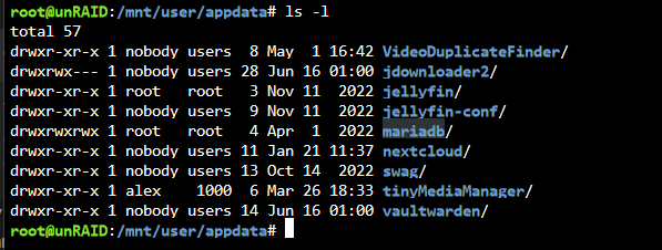

Your two sources seem odd. The one is inside the other. Are you sure those appdata paths are right? Then please share the debug log. The plugin sanitized all other container volumes resulting in nothing to back up. Please also note the info help block from „sources“ field.
By default (after first installation) the plugin has set these two paths:
/mnt/user/appdata
/mnt/cache/appdata
I removed the second one because they point to the same directory. But one through the unRAID filesystem layer (I forgot the name)
I left /mnt/user/appdata as this is the path where all docker container are stored - or is that wrong?
I added the jellyfin-conf directory to as this is not a docker container directory but a directory created by jellyfin docker. It contains all configuration. I wonder why it only works for two docker container directories. Every other directory is in the same location.
I attached a debug log. Thank you. ab.debug.log
Edit: I may have found my problem. For some docker container I changed data dir (where possible) from /mnt/user/appdata/ to /mnt/cache/appdata as they are always on the cache drive and this results in better performance.
I have not changed the configuration back yet. But my question would be:
Is it ok to leave the source configuration (as it was in the beginning) to:
/mnt/user/appdata
/mnt/cache/appdata
Does it not cause issues if they point to actually the same location?
Edited by Pete0
appdata is the Path that store any Data/Configs ... from the Docker Containers.
The Docker Containers himself are stored under /mnt/system/docker.
When you are used the default Paths.
Edited by Revan335
29 minutes ago, Pete0 said:
/mnt/cache/appdata
cache is only the Path for your Cache Pool without the Fuse Filesystem Layer.
user is Cache + Array with the Fuse Filesystem Layer.
