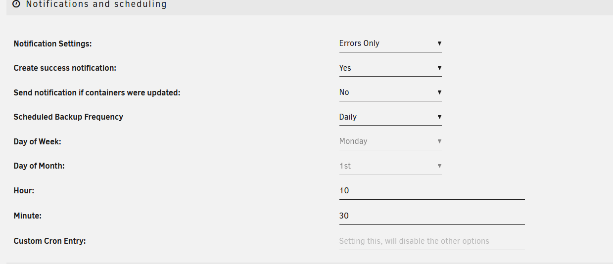

Can anyone help me figure out why the backups won't run when scheduled but work fine when run manually? Am I not filling out the time in the right format or something?
Not sure this will help, but this is the log from the last manual backup: 88c50cb6-03c9-4dce-a55c-b89f00238621
It should've run multiple times since then, and I even changed it to daily and set the time to be about to occur. You can see it's set for 10:30 and I set that at 10:28 and waited, but nothing ran. I originally had it set at 4 in the morning on Mondays.
In case anyone has the same question as me and can't find a solution, the answer was that I had minute blank in my original settings when it was set to weekly. Then, when I was troubleshooting and made it supposed to run in a couple minutes, I didn't realize my Unraid system time was set to the wrong timezone. So two separate errors, but the one that could probably trip up other people was leaving minute blank. Setting it to 0 or to 1 should work.

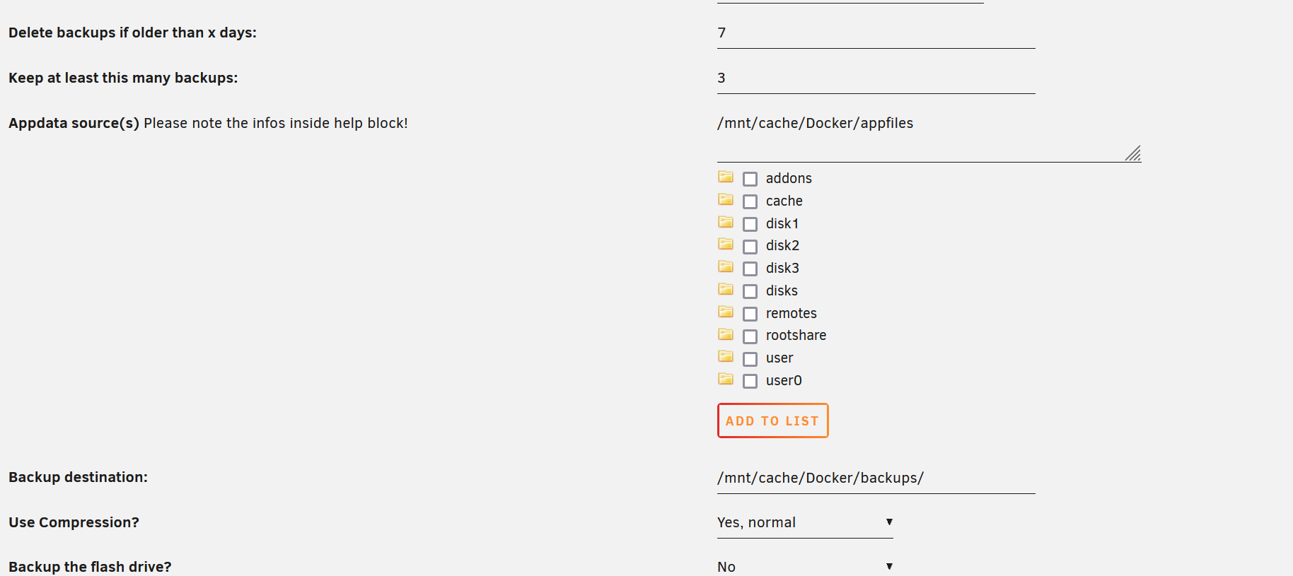

Hi, i have an issue i don't understand:
I setup some paths, hit save and ran inot the issue of having external volumes. Ok fine, just switch back and set the checkbox "External too" and whoops. where is the checkbox ?
