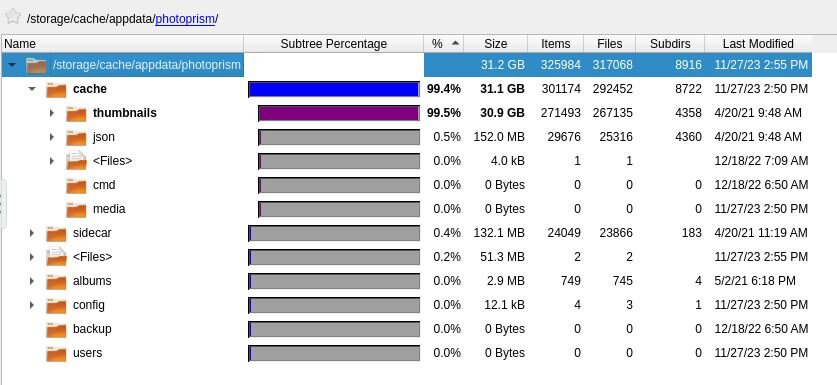

Hi, I'm asking because I tried to backup and found a warning that there was an error in the backup, but I couldn't find a solution.
https://ibb.co/y6nFLJT
Problem 1) Why does it say failed and there is an error?
Problem 2) Photoprism backs up 117GB, why is this?
https://ibb.co/QpmYrZG
First, I went to the location where it was backed up and it says -failed next to the backup time. I can also see here that Photoprism is 117GB in size.
https://ibb.co/8xFqQBL
Appdata.Backup is set up like this.
https://ibb.co/YbTbgZp
Specifically, I have “YES” to skip the one that says “No volumes - container will NOT be backed up!”.
https://ibb.co/R9W6KdL
For Photoprism, I've excluded the photo data (but why is it so big... what do I need to check?)
https://ibb.co/vmF9k2c
I think tdarr might be the error, so I'll share the settings as well.
Finally, I don't know where the log location is shared, so I copy it directly and share it.

I cannot see why photoprism is that big. The log states it only backups the path "/mnt/user/appdata/photoprism" which seems legit. How big is it?
AppData backup notification, backup folder failure indication, logs are all the same.
Photoprism docker capacity is large! I will check this in Photoprism and reduce it!

Photoprism Cache directory holds several thumbnail files for each photo in your library.  It makes up almost the entire appdata directory for the app.  This is one of the reasons I moved on to Immich.  Photoprism just doesn't scale well with large photo libraries.
Wow, thank you. So now I am trying to move sidecar or thumbnails to array in photoprism. It doesn't work well for inputting variables.
The reason I use photoprism is to back up my photos from my iPhone and view them in my photo album. When I come home with photosync, they are automatically uploaded to the iphone folder in the array on the server, and then automatically indexed in photoprism.
Also, when I delete unnecessary photos from photoprism, the corresponding photos in the iphone folder are deleted.
Can Immich use the same process I am doing?
Also, can you tell me what program is attached? or docker? It looks very useful because it has a GUI and you can check the capacity of the folder!
The Immich iOS app can automatically upload photos (can turn on/off this in app).  Like many iPhone apps, you need to actually open the app for it to start this task - an issue for most Apple apps, it doesn't like running things in the background.
I don't believe Immich will remove photos from your phone, so they likely would upload again if removed from the Immich photo directory.
The screenshot is from QDirStat docker.  A very useful tool when trying to figure out what is using your storage space.

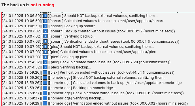

So, two weeks in a row now, the backup has randomly had a near 5 hour long pause. Last week, it took 5 hours to backup a container that usually only takes about 2 minutes, and now this week it took 5 hours between confirming the backup directory and listing the containers to backup.
I never uploaded last weeks log as I thought it might've been a one off (though I do still have a partial version I saved in a notepad file that I apparently never closed), but I do have the one that ran this morning.
0e1158d3-4cb2-4dcb-b7f9-e6fd55741c56
I didn't realise it was still running until I realised Plex was down and tried to boot it back up again (which created an unrelated error in the backup log) but I don't really have an explanation for these gaps, nor why it's been almost 5 hours on both occasions. i'm hoping you could give me some insight in what might be causing this. Thanks!
No, not really at all. I see, that plex backup was running from 11:08:05 to 12:30:57. A "file changed as we read it" occured and the lsof (which file is open within given path) took from 12:30:57 to 12:43:55.
While writing I realize, that the cotainer listing (from dockerMan) took from 05:00:05 to 09:55:21. Thats nothing special and loaded during backup initialization. Seems like Unraid had an issue.
Yeah, the Plex issue was because I didn't realise the backup was still running and started the container before spotting that it was still backing up and shut it back down again, I was expecting that one. If it was just a one-off I wouldn't've thought much of it. But then this happened last week for about the same 5 hourish duration (the one I don't have a complete log of).
