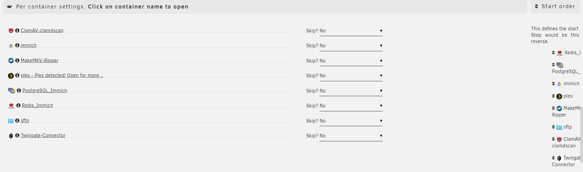

Is there an option to 'Skip All Container Backups' instead of setting each container to Yes to skip the container?
Or
Is there an option to just back up the Flash Drive without backing up the containers?
Having either options would be great if I just want to backup the flashdrive
You do not even need the plugin for that. There is a script that comes with Unraid (that the app actually uses) that you can just run yourself.
/usr/local/emhttp/webGui/scripts/flash_backup
It should generate the backup zip file in Unraid's root directory if there is enough space.
I was trying to avoid creating a script of my own. I figured someone out there created a plugin by now where you can just do everything in the GUI and this plugin is very close.
But thank you for the suggestion, I guess scripting is the way to go

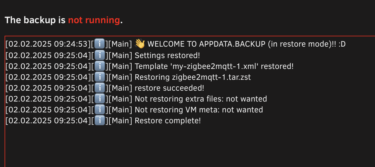

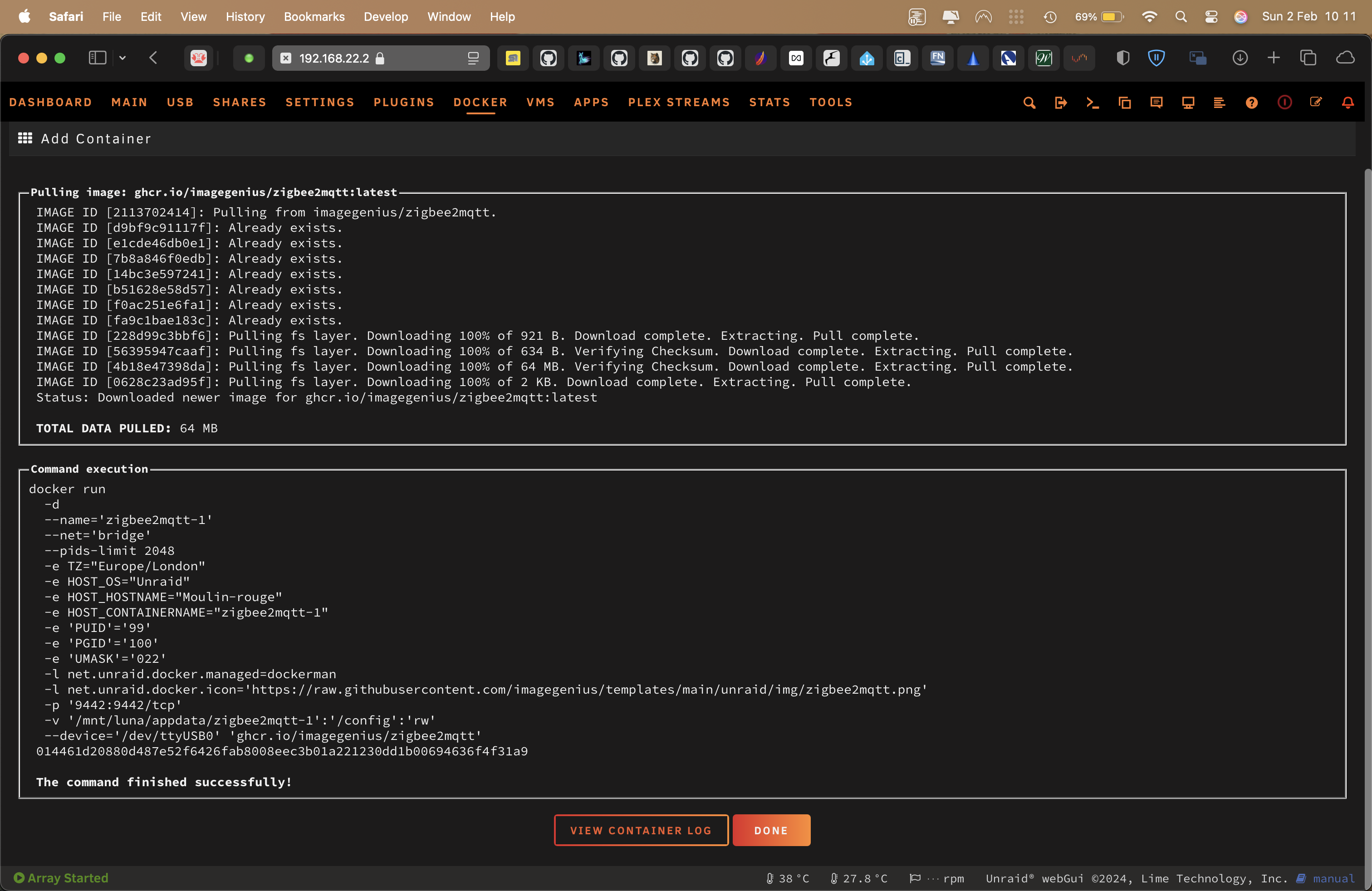

How does restore work? I've clicked through and done the steps but where / how to access the restored container etc.
I've just had a bad update of zigbee2mqqt & want to 'roll back'
Edited by dopeytree
Looking good. Since the restore only does data part, I would recommend:
* delete container
* delete the container appdata
* restore (like you shown)
* create container from template
should fire up the backed up version.
Still downloads the latest version when you add the container..
Edited by dopeytree
The image? Yes, of course. The image has nothing to do with the appdata. If you want to pin a specific image version from that tool, you have to work with image tags. Like imagegenius/zigbee2mqtt:1.2.3

So I still have the issue with the container group order not getting saved, however this time I have some debug info, @KluthR. 😀
I used the new "?debugForm" feature to obtain telemetry, here's what saving the page returned for my MariaDB group:
containerGroupOrder%5BMariaDB%5D=containerGroupOrder%5BMariaDB%5D%5B%5D%3Dmariadb%26containerGroupOrder%5BMariaDB%5D%5B%5D%3DDirectus%26containerGroupOrder%5BMariaDB%5D%5B%5D%3Dlychee
Sadly the order stays like this: Directus, lychee, mariadb, so precisely the opposite of what's needed.
Edited by Glassed Silver
The order string seems wrong, as it always talks about mariadb.
Do you have 6.12.15 ot 7.0.0? If yes, those versions fixed the javascript debug console logging. Please hit F12 in Chrome or Firefox and open the tab "Console" and reload the page and try some ordering, maybe something is displayed there.
