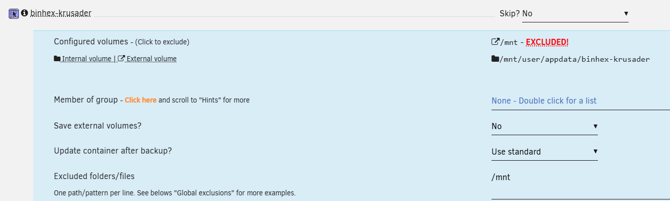

Hi, I'm having problems with backing up containers that have my /mnt/user path mapped into them, as the appdata path that I DO want to back-up is under the external path that I don't want backing up.
[02.03.2025 03:02:49][❌][idrive-docker] tar verification failed! Tar said: tar: /mnt/user/appdata/idrive/config: Not found
since /mnt/user is mapped to a path in the container and is skipped as external then the /appdata that I want is also skipped...
Any ideas?

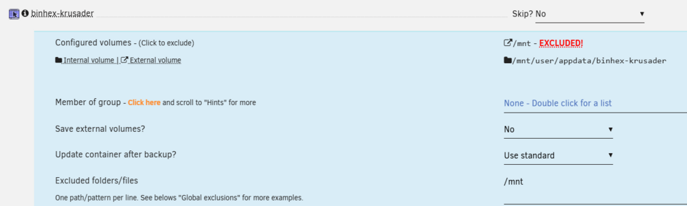

Wouldn't this still be excluded though as if an external path is higher up the tree than the internal one, then all of the internal stuff would be excluded?
e.g.
Wouldn't this configuration mean that /mnt/user/appdata/binhex-krusader would get excluded because /mnt is mapped as an external volume and is excluded in the config?
Edited by CodeThief
Yeah but there's no reason to put it in the excluded list since it's properly recognised as external and backup exetnal volumes is set to No.
