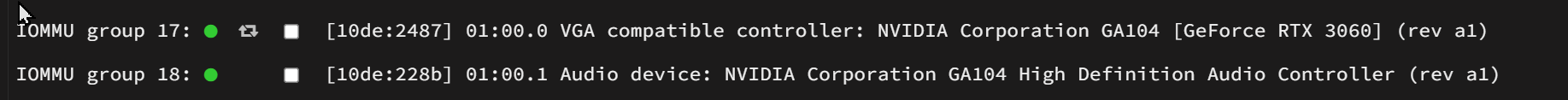

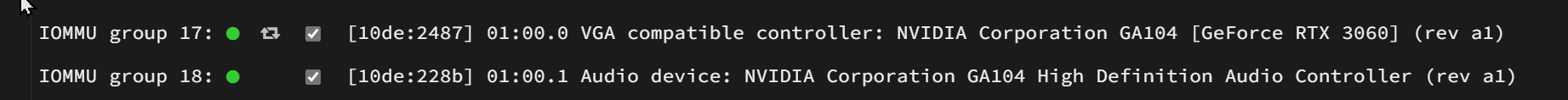

I have unbind the card:

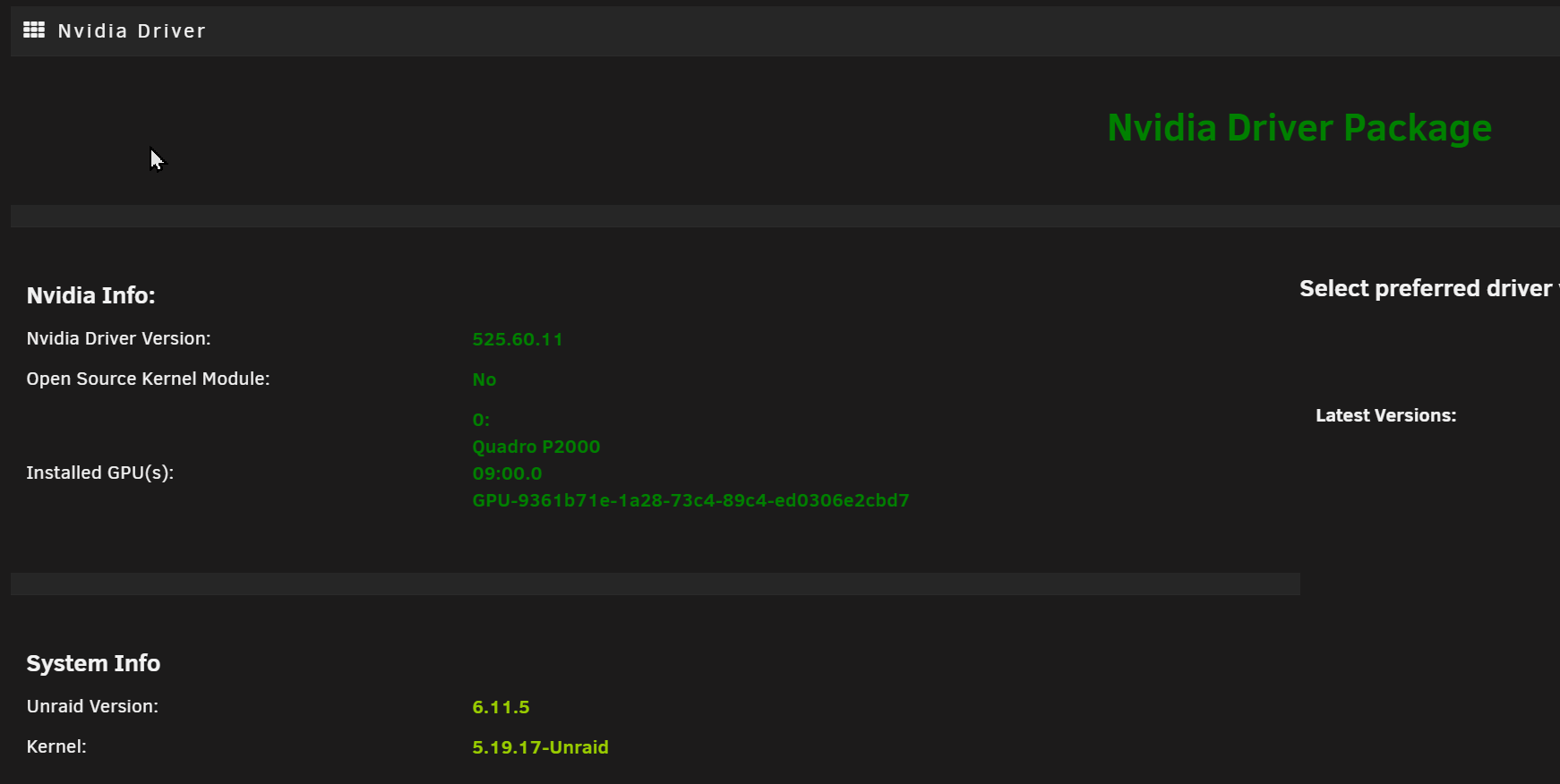

I seem to have a very old Nvidia driver

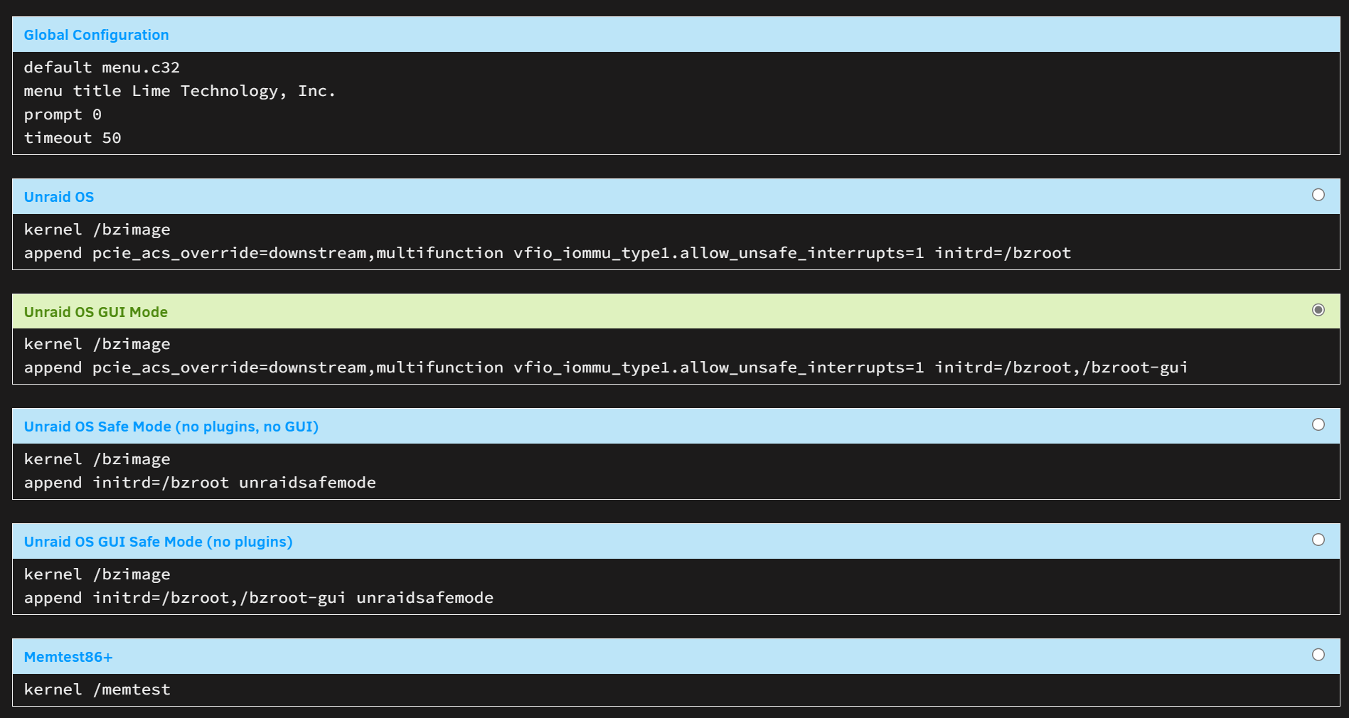

I just looked at the "old" Syslinux Configuration and I can't see any old stubbing here?
To be honest its a very long time since I messed with this so not sure what to look for?

I suspect that the driver will not support both the 3060 and P2000 and updating driver you are unlikely to loose P2000 support.  @ich777 maybe able to adivse.
Please post your Diagnostics.

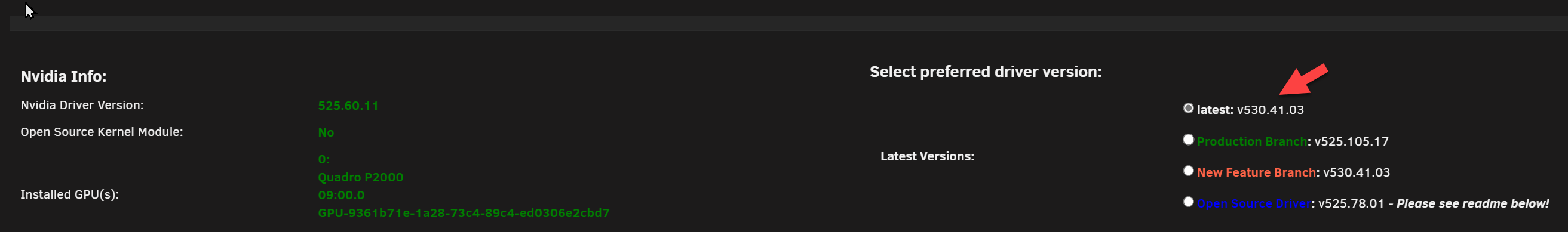

I was afraid to loose support for the P2000 but I did the upgrade and it looks great!

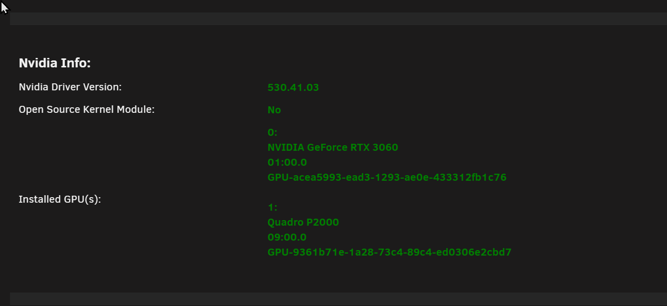

Yes I updated the driver to 5.30.....
- RED arrow to the latest version and got 2 GPU listed). 5.20. to 5.30
