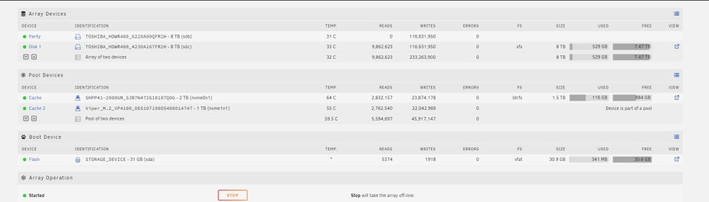

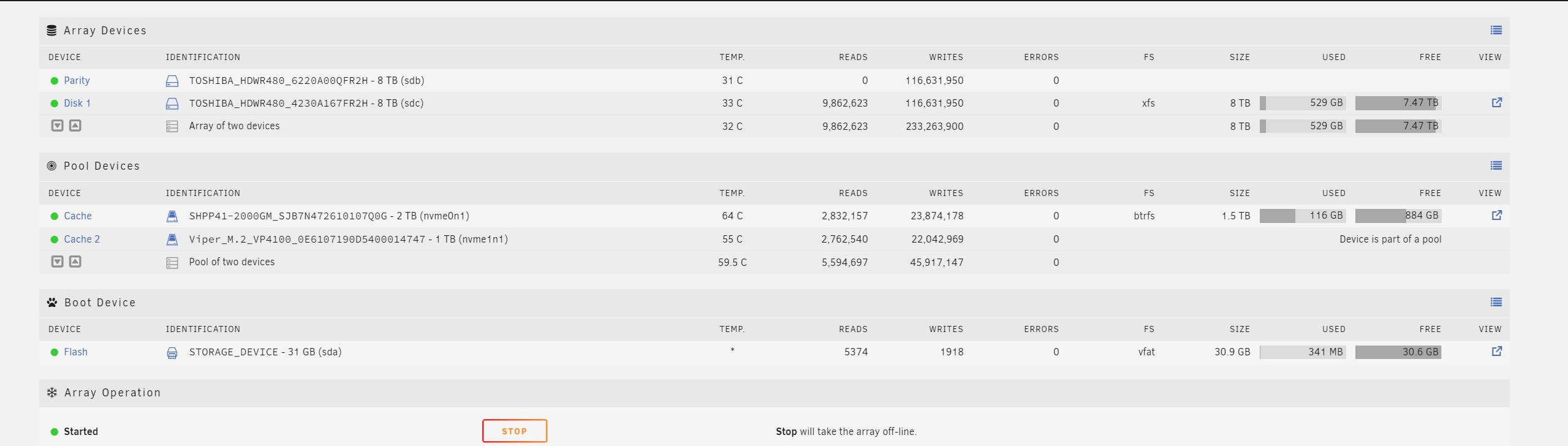

Anyways, I grabbed a screenshot of my array just in case I lose all my settings... I flashed a new drive, and added my license ( basic.key ) expecting I would get a pop-up to transfer the license to the new flash drive. But what happened instead was I got a message that said the flash is blacklisted. Perhaps as if I'm trying to pirate the software or something.

As far as restoring my disk array. That part should be easy, as I grabbed a screenshot.
One additional problem, I had a VM on my cache drive. I don't remember if it was on cache or cache 2... However, I seem to be unable to easily add my second drive to cache.
When I add a second cache, it is in a whole new cache group... it looks nothing like the screenshot that I have... Is there a recommended way to restore cache without wiping the contents?

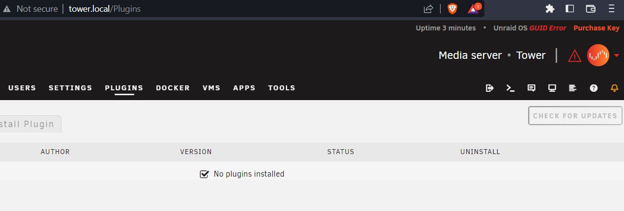

I must have read those instructions wrong... I'm supposed to upgrade a plugin to "2023.03.09.1140" or higher. In order to be able to replace my key...
However, I don't have any plugins installed.
So how do I update a plugin that I don't have installed?
Edit : Added screenshot... also
Maybe I need to start the array before I can see plugins?
But one cannot start the array, without a license.
