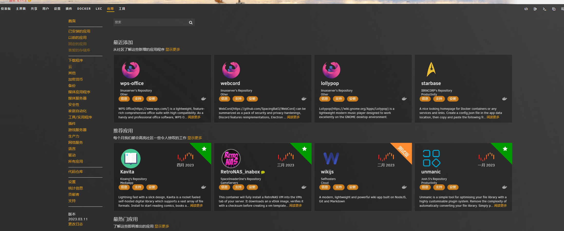

April 15, 20233 yr 1 hour ago, Maxson said: 已经试过多次,没有用,才发帖请教的。 你卸载语言包后,有没有用清理插件清一下啊,有时候是有残存的,而且最好是卸载后重启一下unraid,恢复到英语界面,然后在应用里删掉之前下载的文件,再重新下载安装。

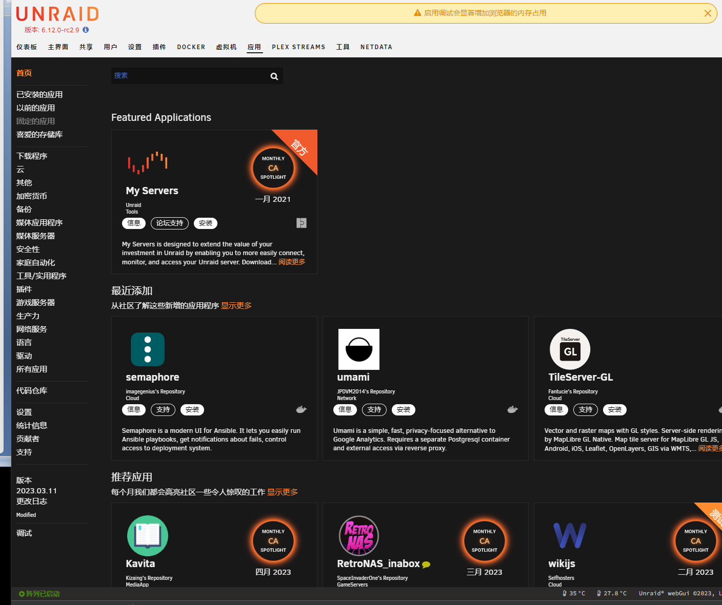

April 15, 20233 yr This will get you running temporarily. Download the attached and save it on the flash drive cp /boot/apps.txt /usr/local/emhttp/languages/zh_CN/apps.txt rm /usr/local/emhttp/languages/zh_CN/apps.dot apps.txt
April 15, 20233 yr Author 3 hours ago, Squid said: This will get you running temporarily. Download the attached and save it on the flash drive cp /boot/apps.txt /usr/local/emhttp/languages/zh_CN/apps.txt rm /usr/local/emhttp/languages/zh_CN/apps.dot apps.txt 20.99 kB · 2 downloads 不起作用,我比较了你提供的文件,和我系统文件的内容一模一样。
April 15, 20233 yr 48 minutes ago, Maxson said: It doesn't work, I compared the file you provided, and the content of my system file is exactly the same. There's 2 brackets missing on the file I uploaded. They were causing the issue being present.
April 15, 20233 yr Author 24 minutes ago, Squid said: 我上传的文件中缺少 2 个括号。他们导致了问题的出现。 我用你提供的文件和命令,未能解决问题。 有其它的解决方法吗?
April 15, 20233 yr Solution I just tried it... it works Other than that you have to wait for another update to the language
April 15, 20233 yr Author 16 minutes ago, Squid said: I just tried it... it works Other than that you have to wait for another update to the language 我明白了,非常感谢。

April 24, 20233 yr Author On 4/15/2023 at 7:39 PM, Squid said: This will get you running temporarily. Download the attached and save it on the flash drive cp /boot/apps.txt /usr/local/emhttp/languages/zh_CN/apps.txt rm /usr/local/emhttp/languages/zh_CN/apps.dot apps.txt 20.99 kB · 21 downloads 最终解决办法: 1、停止阵列 2、复制附件的 apps.txt 到U盘根目录覆盖原文件 3、在终端内执行上面提供的命令 4、重启阵列 5、成功修复
April 27, 20233 yr Author 7 hours ago, lvxj11 said: 更新了中文插件可还是老样子 最终解决办法: 1、停止阵列 2、复制附件的 apps.txt 到U盘根目录覆盖原文件 3、在终端内执行上面提供的命令 4、重启阵列 5、成功修复
