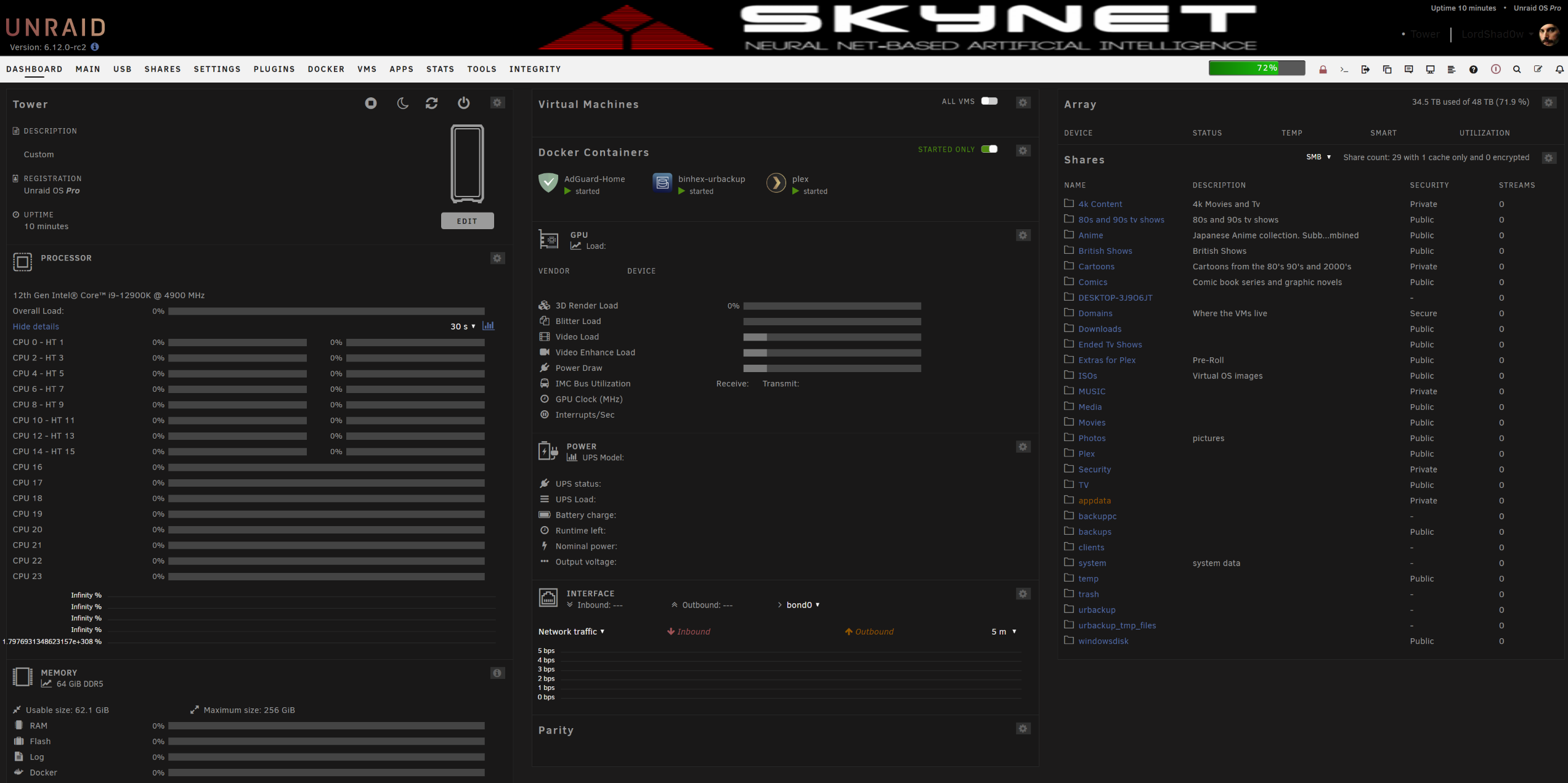

I did do that and it seemed to go fine but I pulled the card in the interim as I seem to be having some weirdness still and can't find the cause in the logs+google+here.
Lierally nothing on my dashboard shows activity now (no CPU activity or network or anything) and the section that listed my drives is just.. gone?
I didn't change anything. I had previously added mullvad browser and an old windows 11 installation but have since removed them.
Also my 2tb nvme drive has apparently vanished. Physically installed are 3 nvme drives, One is a 2tb samsung and the other two are 1tb otherbrand. Those show up fine in the disks section.
So, no idea what is happening but here are diags from a few minutes ago and hopefully they provide some insight as to what I need to fix to get things happy again.
tower-diagnostics-20230423-0014.zip
Downgraded to RC-2 to see if it would repair itself but this is still what I am looking at/

If anyone could take a look and give some advice, I would really appreciate it.
Try booting in safe mode and/or using a different browser.
WIll do. What should I be looking for and trying to fix? :)
No change to anything with either edge browser, chrome, firefox, opera or safemode with the different browsers listed.
Suggests recreating the flash drive and only restoring the bare minimum from the current one, like the disk and pool assignments (super.dat and pools folder), key and docker user-templates.
Ok. I will read up on that and update once I do. Thank you Jorge.
The only solve for this was a completely fresh install on a new USB and new key (using the replace key option, retaining assignments as you suggested)
