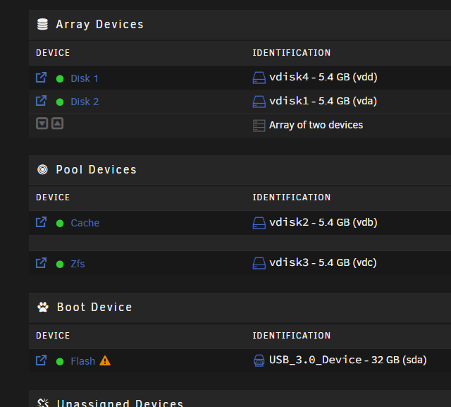

I have a test Unraid VM running under unraid. For the disks you can specify the serial, I suspect you should be able to do in prox? Serial in the libvirt is the Id for the disk in Unraid.
      <source file='/mnt/user/domains2/Unraid-VM/vdisk1.img' index='5'/>
      <backingStore/>
      <serial>vdisk1</serial>
      <alias name='virtio-disk2'/>
    </disk>
Which maps to this on the qemu cmdline
-blockdev '{"driver":"file","filename":"/mnt/user/domains2/Unraid-VM/vdisk1.img","node-name":"libvirt-5-storage","auto-read-only":true,"discard":"unmap","cache":{"direct":false,"no-flush":false}}' \
-blockdev '{"node-name":"libvirt-5-format","read-only":false,"cache":{"direct":false,"no-flush":false},"driver":"raw","file":"libvirt-5-storage"}' \
-device '{"driver":"virtio-blk-pci","bus":"pci.0","addr":"0x6","drive":"libvirt-5-format","id":"virtio-disk2","write-cache":"on","serial":"vdisk1"}' \
