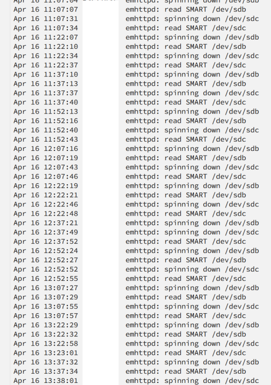

Preclearing a drive, is this normal in main logs
I am starting a new server for a small amount of drives as a backup. Got new drives was preclearing them before starting the array with them. is this normal to see this in main logs? Temps seem fine and speed seems good. The green dont on the drives while they are precleaning goes gray for about a half second. Done preclearing before but just never looked at logs.

Disable spin dow while they are being precleared.
Ill try that. But preclear is actively reading or writing to them so shouldn't that keep them from spinning down in the first place
It might not since it uses dd.
thank you this worked
