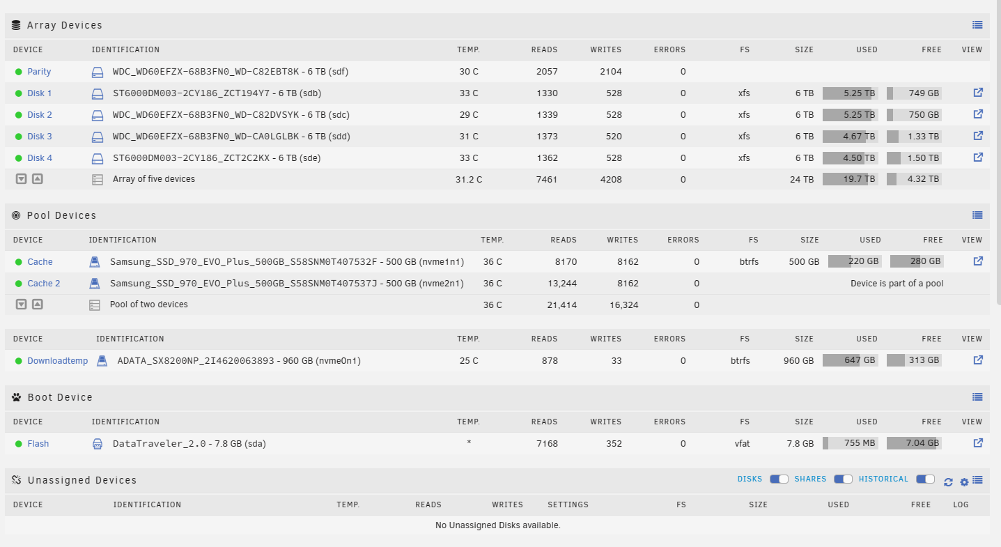

To give you a little background; two weeks ago I replaced a JKTINK 6 port SATA PCIE expansion card with for a Silverstone ECS07. Everything worked fine for about a week. Then I decided to move my "domains" share from my downloadtemp to my cache. Everything worked fine for a couple of days. I wake up this morning and the server is in a reboot loop (every 20 min). No clue what changed or what happened to trigger this behavior.
Couple things to note:

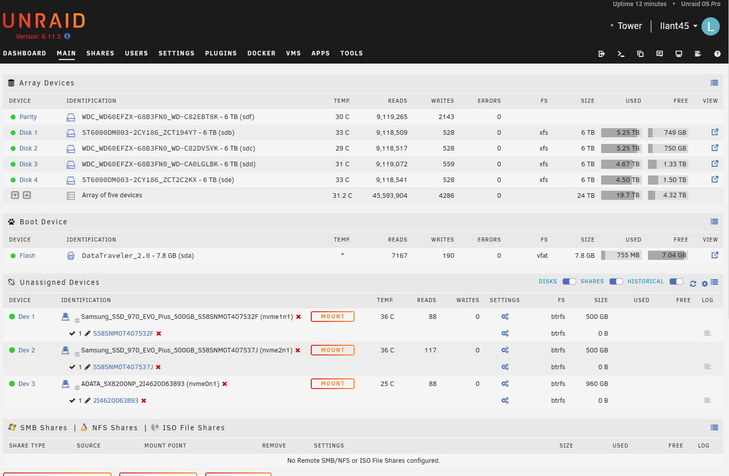

- For some reason, every time the server reboots, the 3 nvme's are under Unassigned devices. (see screenshots attached). I put them back as cache and after the next crash they are back in Unassigned devices.
