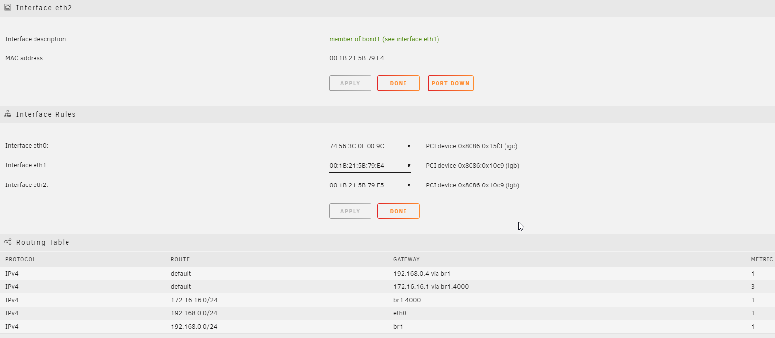

I am having some trouble acheiving my desired network config. Problems I have right now:
  1. No internet Connection for Trial Key to start Array
  2. Static IPv4 assigned to Br1 (Bond of eth1 & 2), appears to come from MAC address on eth0

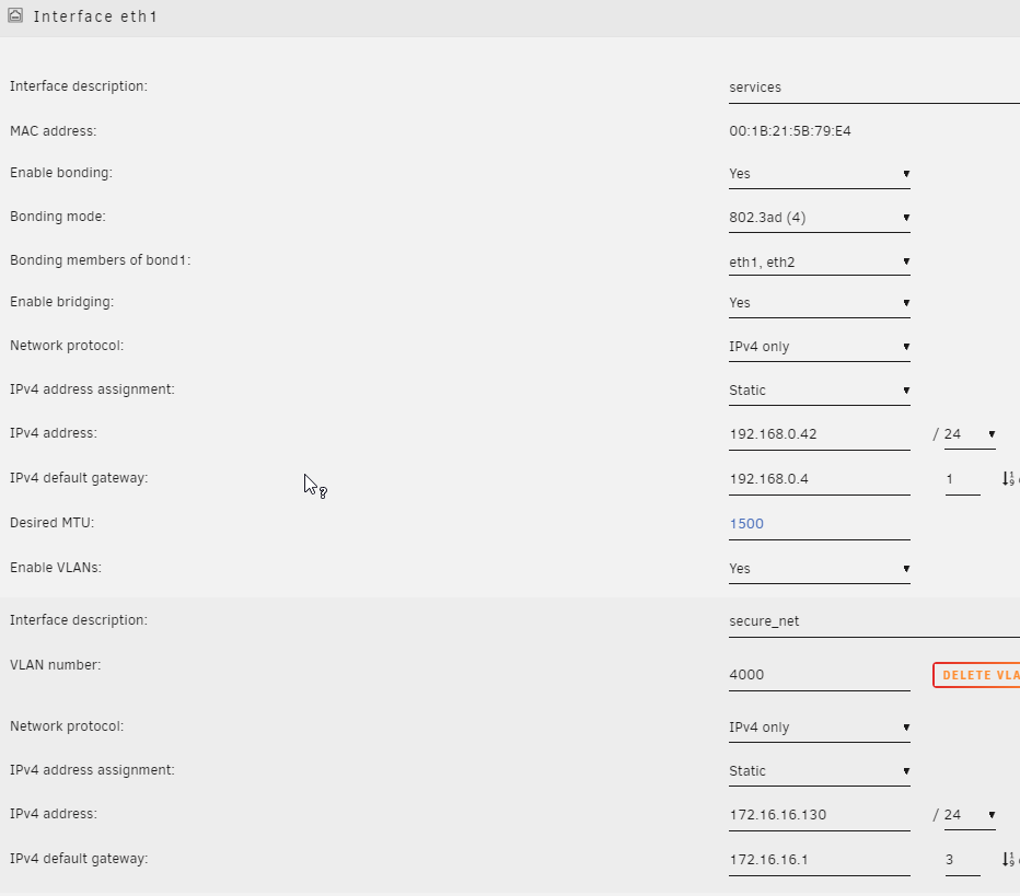

I would like to achieve this:

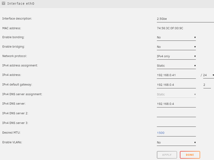

Onboard NIC > Unraid WebGUI Only
  1. Static IPv4
Dual port NIC > LACP Bond0 > Br1 & Br1.4000 VLAN
  1. Br1: static IPv4 with default bridge for Docker Containers & VMs
  2. Br1.4000: static IPv4 bridge for apps that should use a VPN
At the moment I am on a Trial Key and the webgui says there is no internet connection - I think it has something to do with me changing the Default GW metric on Bond0.

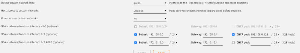

I am not sure how to change the default docker interface for the bridge. Is that possible?
This is what I have so far (and I also attached the diagnostics):
