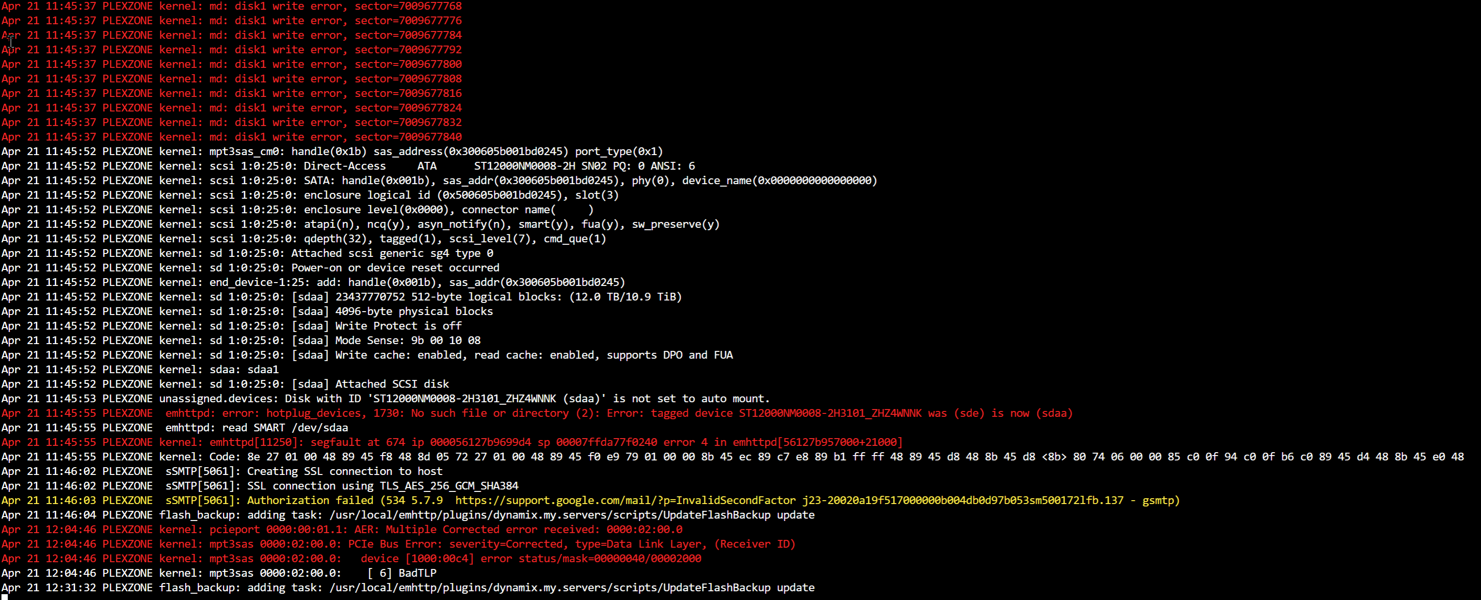

Most of this just started during a rebuild of a new replacement drive nr. 18 I got this error:
And log from Disk 1:
But I guess it best to wait for the drive 18 to finish rebuild before trying to do a reboot and rebuild drive 1?

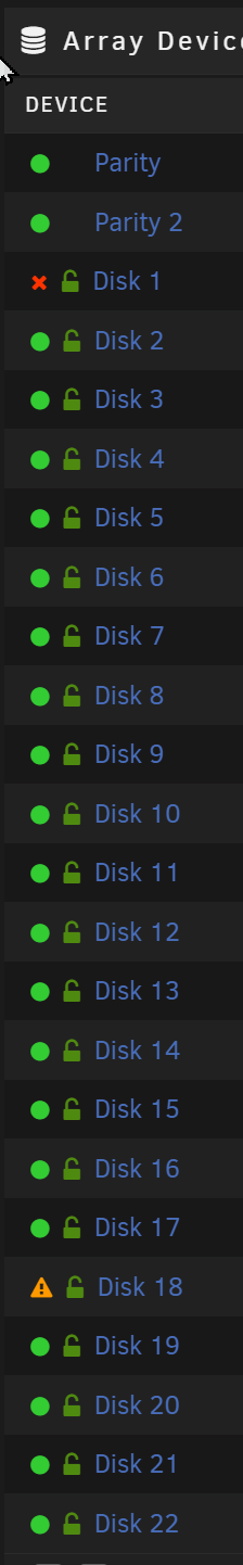

Since it looks like I am emulating 2 drives! dISK 1 and disk 18

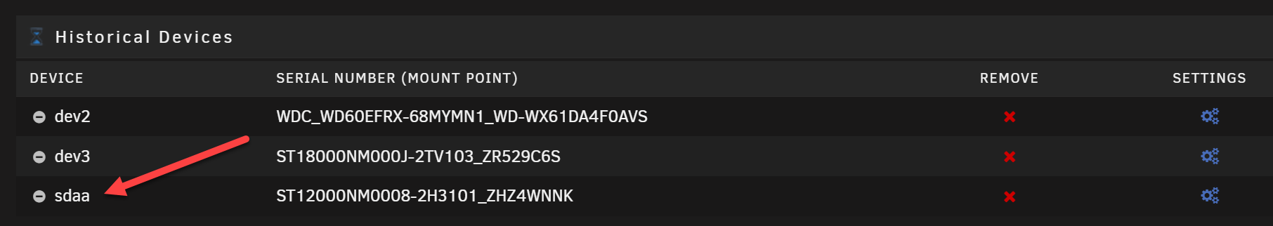

Drive 1 now shows up under Unassigned drives?

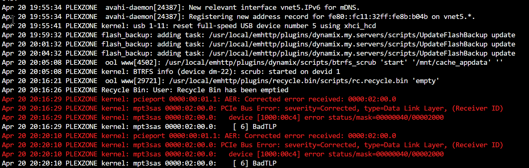

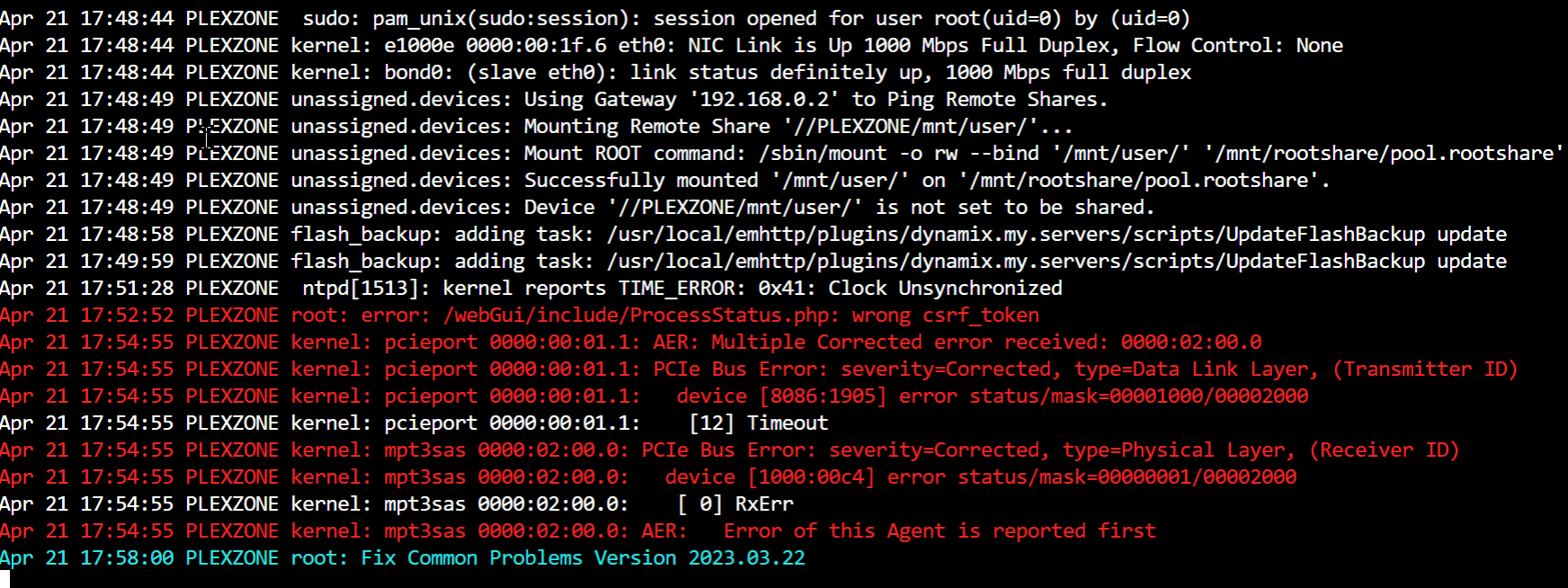

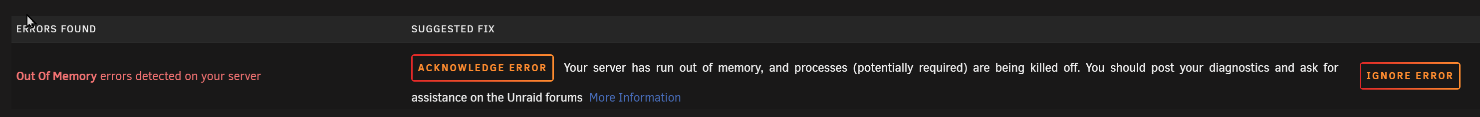

On top of this I am getting some strange other strange errors and behaviors:
Run out of memory message:

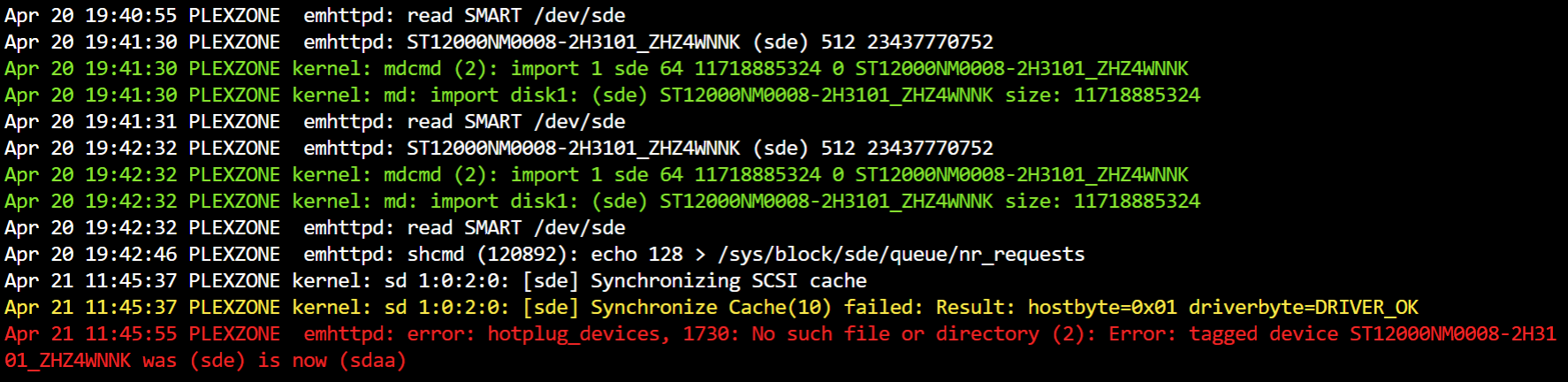

So before disk 1 was removed it was named:
And now it says (sde)
Any input on how I can get my disk back into the array?
Missed this post before, disk1 dropped offline, SMART looks good so check/replace cables and if the emulated disk is mounting and contents look correct you can rebuild on top.

  3. BUT then it stopped and when I looked in the log file I got this:

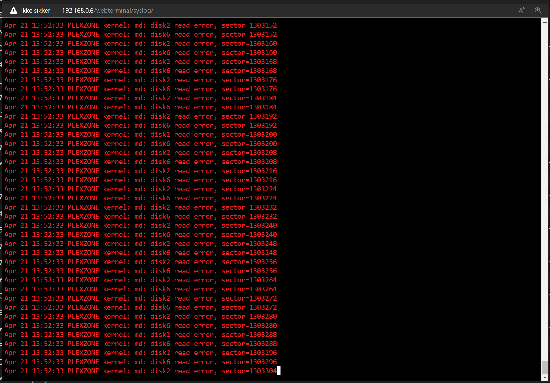

Now its writing error on drive 2 & 6
I have shutdown the server and now I dont know how to proceed?
New diagnostic files attached here:
!!diagnostics-20230421-1352.zip
Cables look fine, temperature fine, controller LSI Logic SAS 9305-24i Host Bus Adapter have connection to all drives.
Disks 2 and 6 also dropped, this is usually a power/connection problem, could also be a bad PSU.
@JorgeB That could explain it! I dont believe its cables or the controller. So PSU actually makes sence!
So I dont dare to turn it on before I have a replacement PSU (I report get back when I have been out shopping for one)

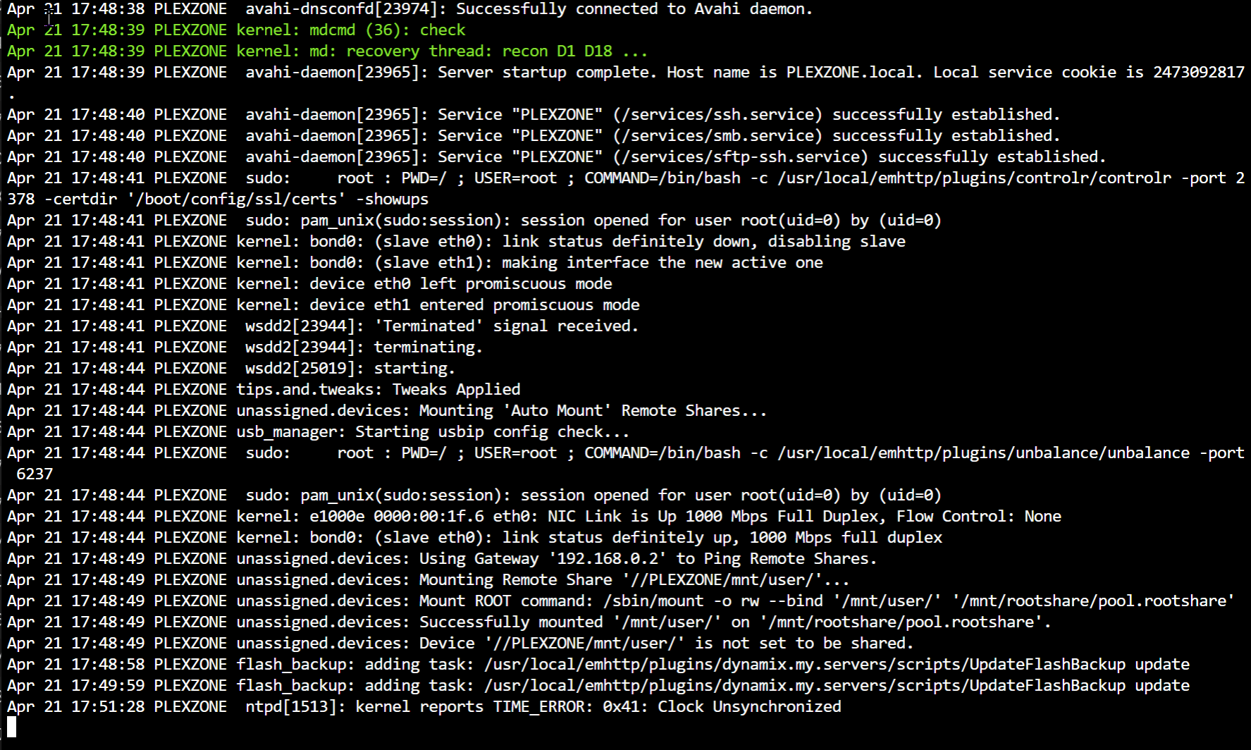

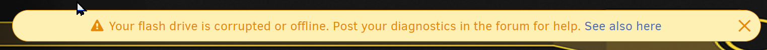

Okay @JorgeBI got a brand new 1000W Corsair PSU and I just booted the server now I get a new error message:
I am pretty sure I have a backup on my Unraid account?
BUT I can see the drive 18 is started to rebuild! and the logs doesn't show any errors! so far so good!
Getting new errors again, but its still rebuilding (ETA 4 days!)
So what should I do now? wait for two drives to rebuild?
Do I need a new USB for Unraid?
It only appeared at start up and I have not seen it since. I can see that it it did a backup of the USB to "My server" so that also worked!
That's a good thing right.

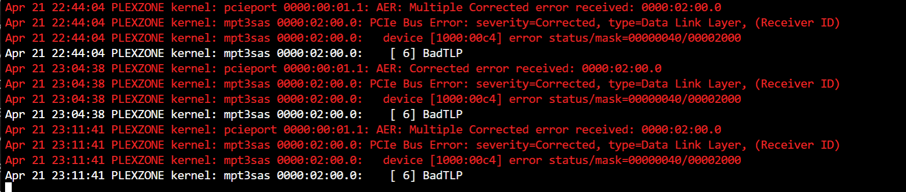

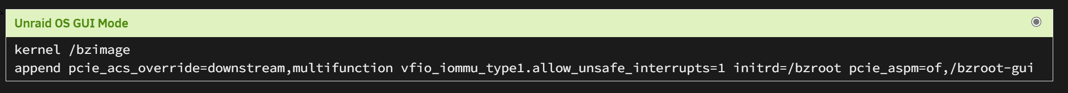

So I added the pcie_aspm=of and did a reboot and startet to rebuild and no errors but after some time I start getting these again?
You can try a different PCIe slot for the HBA, if it's in a CPU slot try a PCH one, or vice versa.

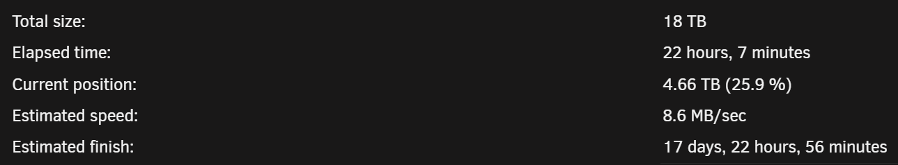

Unfortunately look like it is going to take (4-5 days) a very long time for the 18TB + 12TB drives to rebuild.

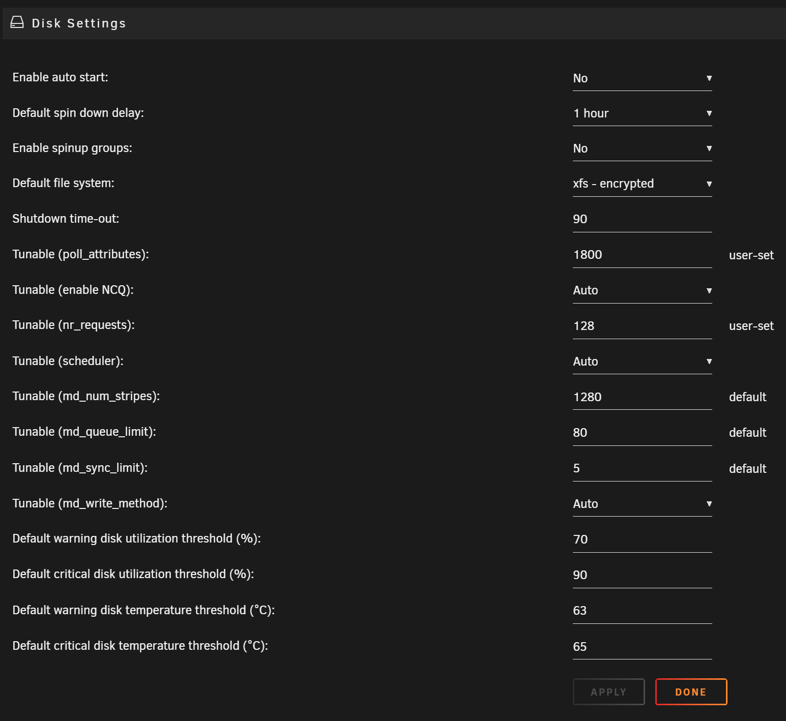

Is there any tweaks I can use to do this faster? (Thinking of the disk settings, most is larger and faster drives)
So far I think its very standard values (I have tried to search the forum but haven't found any newer post about this subjetc
Since v6.8 tuning doesn't usually changes much, what is the current speed?

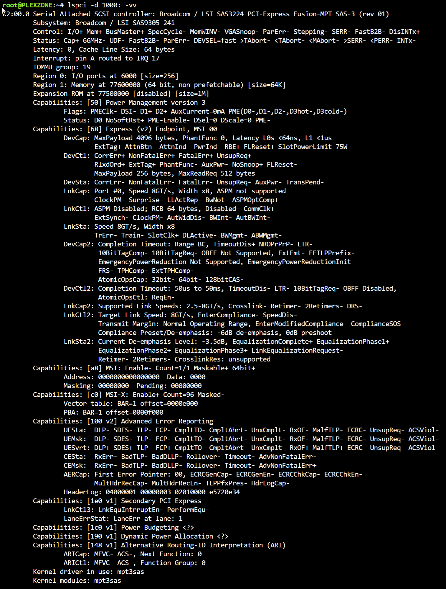

Also post output of:
lspci -d 1000: -vv
Hi JorgeB
Speed is at highest 120MB/sec and now pretty low 8.6 MB/sec most of the time:
lspci -d 1000: -vv
Post new diags when the speed is low like that.
