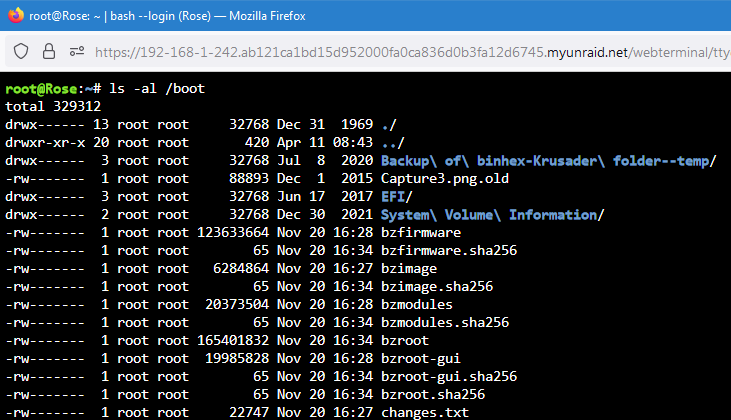

I'm trying to get access to /boot from a code-server docker in order to edit directly the docker compose files.
When I map the folder I get an access error telling me that I don't have the permissions to do it, I'm sure this can be done but how?
Thanks in advance.
Here is a big clue:
You should be looking at the owner, group and the permissions of the various files and directories.  Your Docker will need to be running as root to begin with...
  • 1 year later...
Thank you @Frank1940 for your hint!
Changing the following environment parameters gave access to Code Server to the boot folder:
    environment:
      - PUID=0
      - PGID=0
