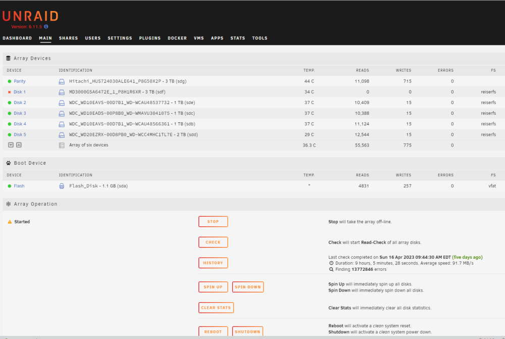

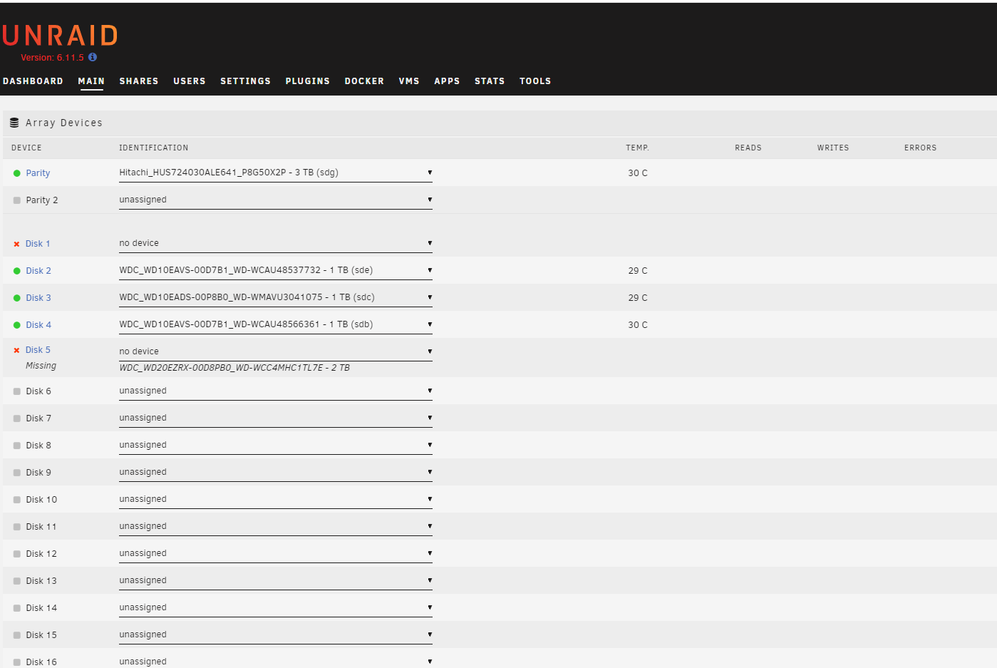

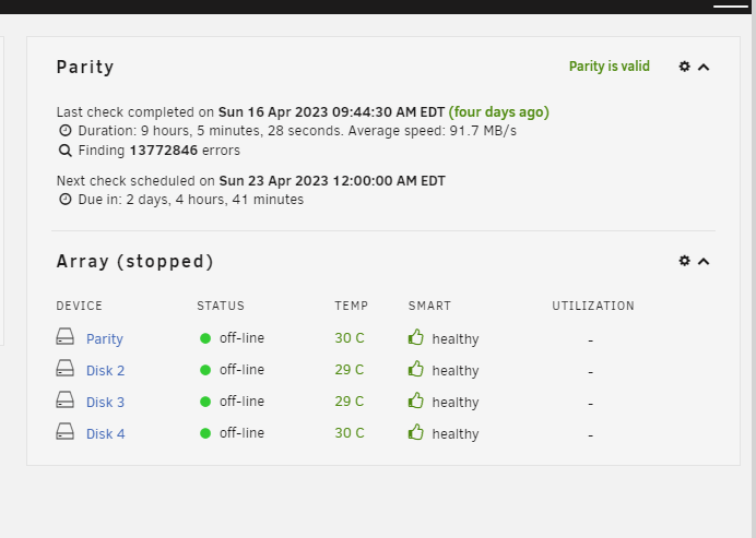

When I web into the server I see this:
The problem is disks 1 and 5 are gone...

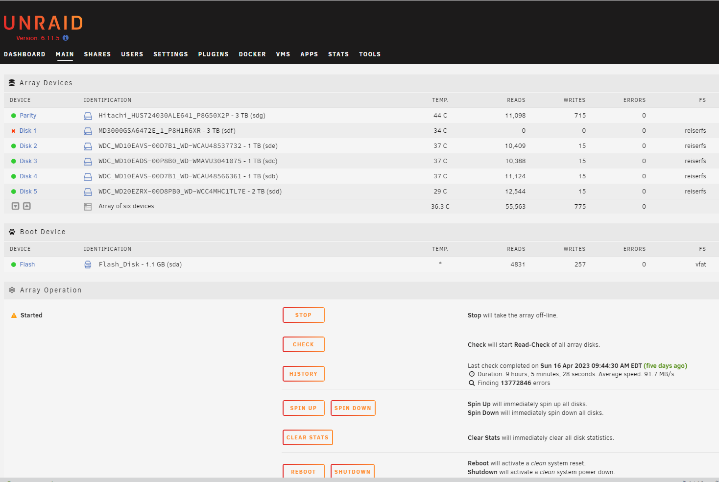

When I click on the main tab I see this:
When I download the syslog I get an empty zip file.  How do I proceed?  Did I just have a double disk failure?  I replaced Disk 1 about a month ago, if that matters.

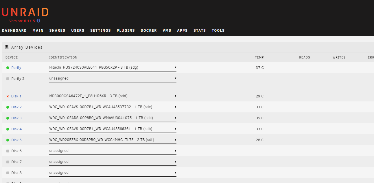

I powered down the server rebooted it and now I can see both the disks in the main tab.
I ran a SMART test on disk 1 last night.  It came back clean 0 errors.  I attached the diagnostics zip to this post.  Am I safe to re enable Disk 1?  How do you do that, I'm stuggling to find the "enable" button in the Disk menu.

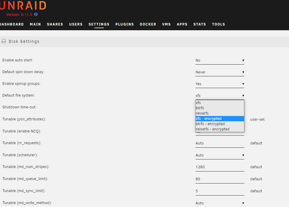

when you say convert to xfs is there where I would do that?
