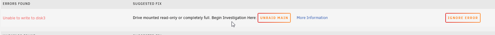

In the fix common problems I have an "Unable to write to disk3" error but the disk itself has no errors and is green lit. Still I performed a file system check in maintenance mode for this drive and my cache drive to be sure. Both came back clean.

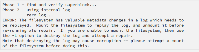

Did you run it without -n? There's some fs corruption on that disk
I ended up having to run it with -L due to the error below. It worked and I'm now re-installing all of my docker containers. Thank you
