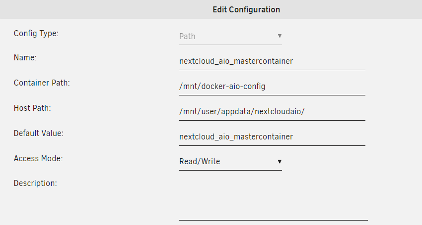

In a previous posting helping someone else @szaimen indicated that for a similar error
==>"Please change -v /mnt/user/appdata/nextcloud-aio:/mnt/docker-aio-config:rw to -v nextcloud_aio_mastercontainer:/mnt/docker-aio-config:rw "
Runninng the command  "sudo find /var/lib/docker/volumes -name configuration.json "  generates the below
/var/lib/docker/volumes/nextcloud_aio_mastercontainer/_data/data/configuration.json
@szaimen Had indicated
When I understand you old config correctly, you most likely need to rsync the data in /mnt/user/appdata/nextcloudaio/ to /var/lib/docker/volumes/nextcloud_aio_mastercontainer/_data/ and recreate the mastercontainer with the correct command which should make things work.

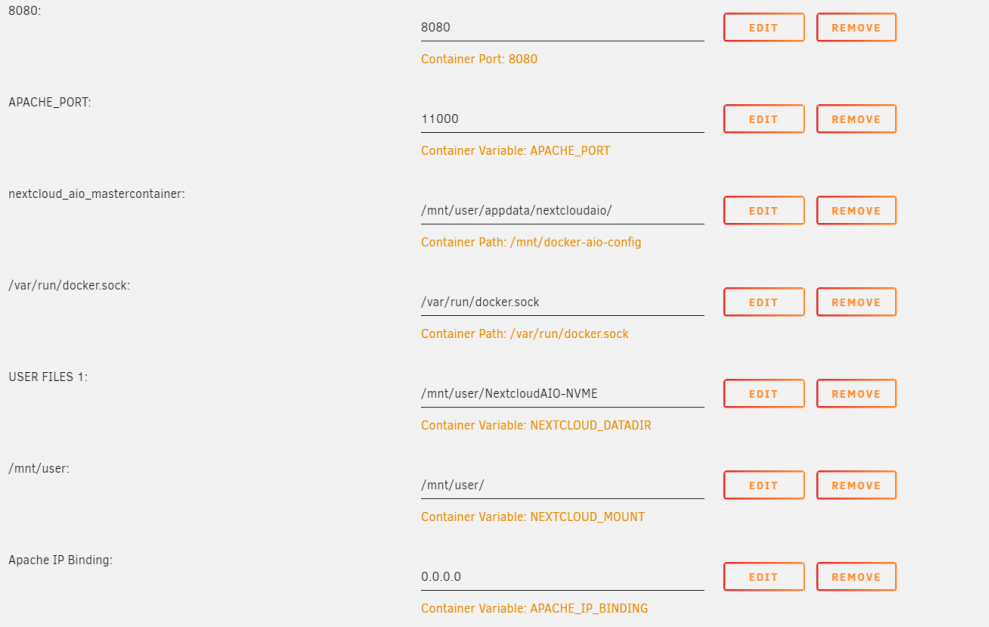

I apologize if it seems like a stupid question but as I am new to Linux I wanted to make sure I understand before I attempt and screw things up further.  After much looking online I think for the rsync command suggested I would put in the below in terminal correct  ??
rsync -av /mnt/user/appdata/nextcloudaio/ /var/lib/docker/volumes/nextcloud_aio_mastercontainer/_data/
THEN would I have to go into the NC-Master Container template and change the configuration  to read at HOST line to:
"/var/lib/docker/volumes/nextcloud_aio_mastercontainer/_data/ "
Would I keep the "_data"  or should it be without it?
If it is helpful to post the sudo docker inspect nextcloud-aio-mastercontainer  please let me know
I appreciate the collective wisdom in what is likely hopefully a simple fix and me just wanting to be cautious before I bork things further lol
