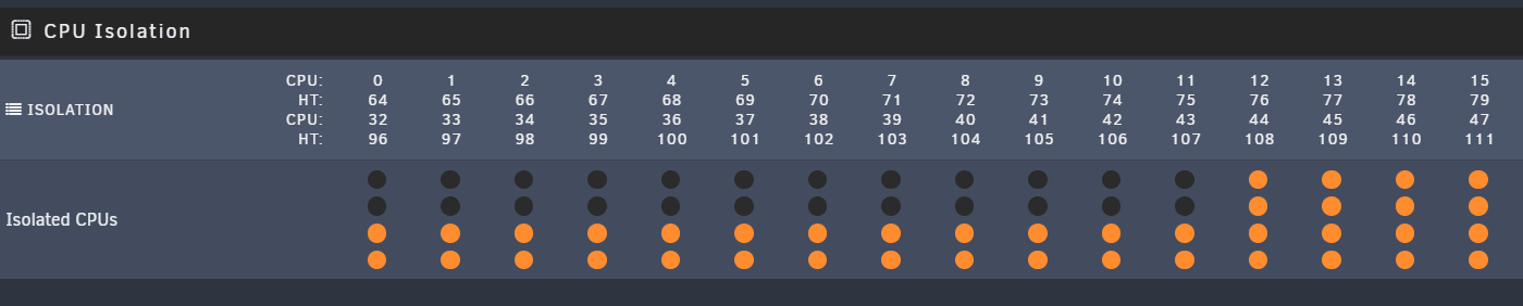

Have you isolated some cores to be used only by the VM?
in Unraid, goto Settings > CPU Pinning.
Try to isolate 4-6 cores (8-12 with threading) and see if you get better performance.
Also, it is beneficial if you post your xml (copied while the VM is off).
What machine-type are you using? i440 or Q35? Try with Q35.

Gents, thank you both kindly for your suggestions, however I have now decided to go the seperate PC route.
Thanks again.
