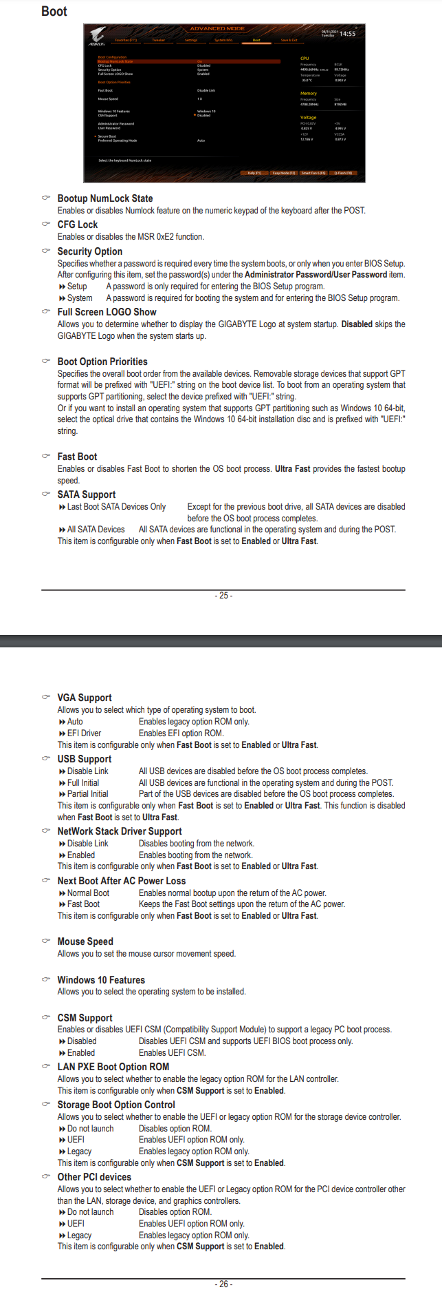

I’ve tried all the settings I can from the advanced BIOS settings guide and I’m still not able to get unraid to boot.

Do you see the USB in the bios? Disable fastboot
USB support enable Full and select USB falsh in boot option priority.

The usb full is actually under fast boot
