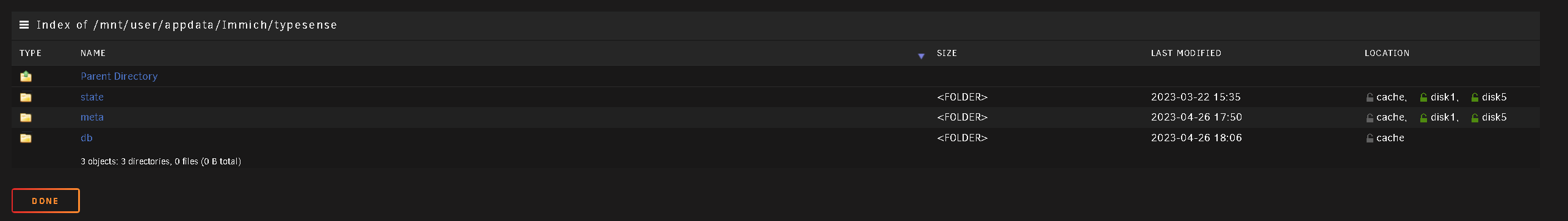

I have narrowed down my issue... :/  hopefully the last one.
I have files from my dockers showing on cache and array where the move process stopped, either from me restsrting from a paused system or the docker still running during the move of the appdata from cache to array.
How do i sort this, how do i get the rest of the data off the cache to array, move doesnt do anything.
Edited by Greygoose
Enable mover logging and check the syslog to see why the files are not being moved, they won't be moved if for example they already exist on destination, or if they are in use.
